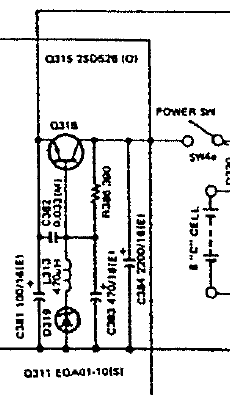

I read about an issue with the AGC, but that was described as affecting AM differently than SSB. I tried a 12V DC power supply from an PC, and that reduced the noise but didn't eliminate it. The voltage regulators (2, one for 9V and one for 5V) are simply a zener and transistor.
Just FYI, here is the schematic of the 9-V supply:

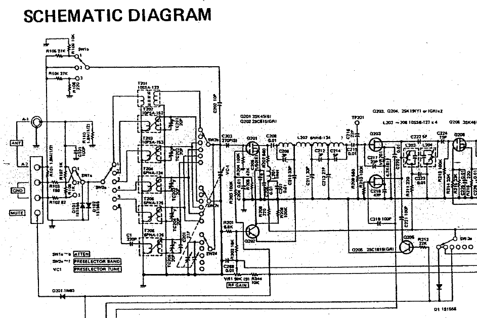

The periodic noise goes away when the antenna is disconnected. With antenna connected (or me touching the terminal) and every electronic device unplugged in the house, the noise is present. I did not just turn the devices off. I unplugged the computer, modem, router, a small radio in the kitchen, and the supply where the FOIS enters the house. I do not know of a single smps within 1800 feet that was plugged in. If it is a signal, shouldn't the strength vary with the antenna? Could just loading the antenna input, like with my body, be causing the noise? I've uploaded that part of the schematic. The poor quality is because it is a scanned copy off the Internet.
