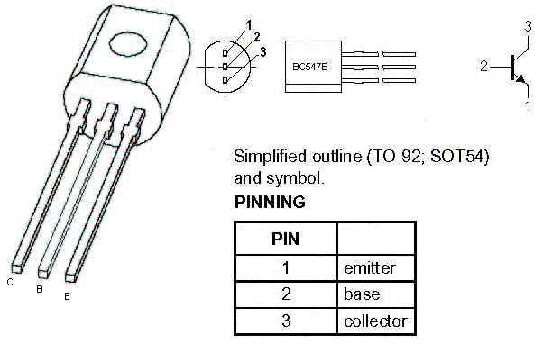

BC547's have 3 pins, i take it the middle pin is the in pin (2) and pin 1 & 3 are the out pins ? also i have a 2N3055 Relay with 2 pins.. pretty straight forward looking, but just checking, left pin is in, right pin is the output ??? not sure that makes sense... :(
The components you describe are both transistors. The BC547 is a Low power Low frequency NPN-bipolar transistor in a standard To92 case. Look at the component from below, with the notch facing to your left. The first lead at the top is the Base. Middle lead the Collector and bottom lead is the Emitter. This Transistor has a max current rating of 100mA and a gain (i.e. current flowing into base, x gain = current flowing into collector) of between 420 - 800.
The 2n3055 is NOT a relay but also an NPN transistor. It is designed for Power applications (requiring high currents) and has a maximum current handleing of 15A. The case style is a To3. The reason for all the metal is so that the transistor can more efficiently dissipate heat when handling higher loads. It is really designed to be attached to a heatsink. The two pins veiwed from below, and slightly offset to the left are - upper emitter and lower base. As for the collector? well the whole case is the collector! This is the equivelent 'third' pin if you like and would have to be connected to the circuit through a 'bonding' wire or similar. The gain of this device is relatively low, about 50 times.

olly_k said:
<snip>The first lead at the top is the Base. Middle lead the Collector and bottom lead is the Emitter.<snip>
The **broken link removed** I looked at says 1=emitter, 2=base, 3=collector, top to bottom when viewed as you said. Do you have a different datasheet?
well.i have worked with bc 547b and im sure that its top-to-bottom as u say the order is 1-collector 2-base 3-emitter
The small-signal transistors have old standard pinout, as picture show.
HF or driver transistors pinout order often same as TO139 package.

The datasheet I looked at says 1=emitter, 2=base, 3=collector, top to bottom when viewed as you said. Do you have a different datasheet?
I think it must be a mistake in my catalogue - it says T092 but I am wandering if not a to92a. When I can be bothered (the wheather and work have wiped me out last couple days! lol) I will get a 547 out from the garage and stick it on my atlas and see what that tells me!
