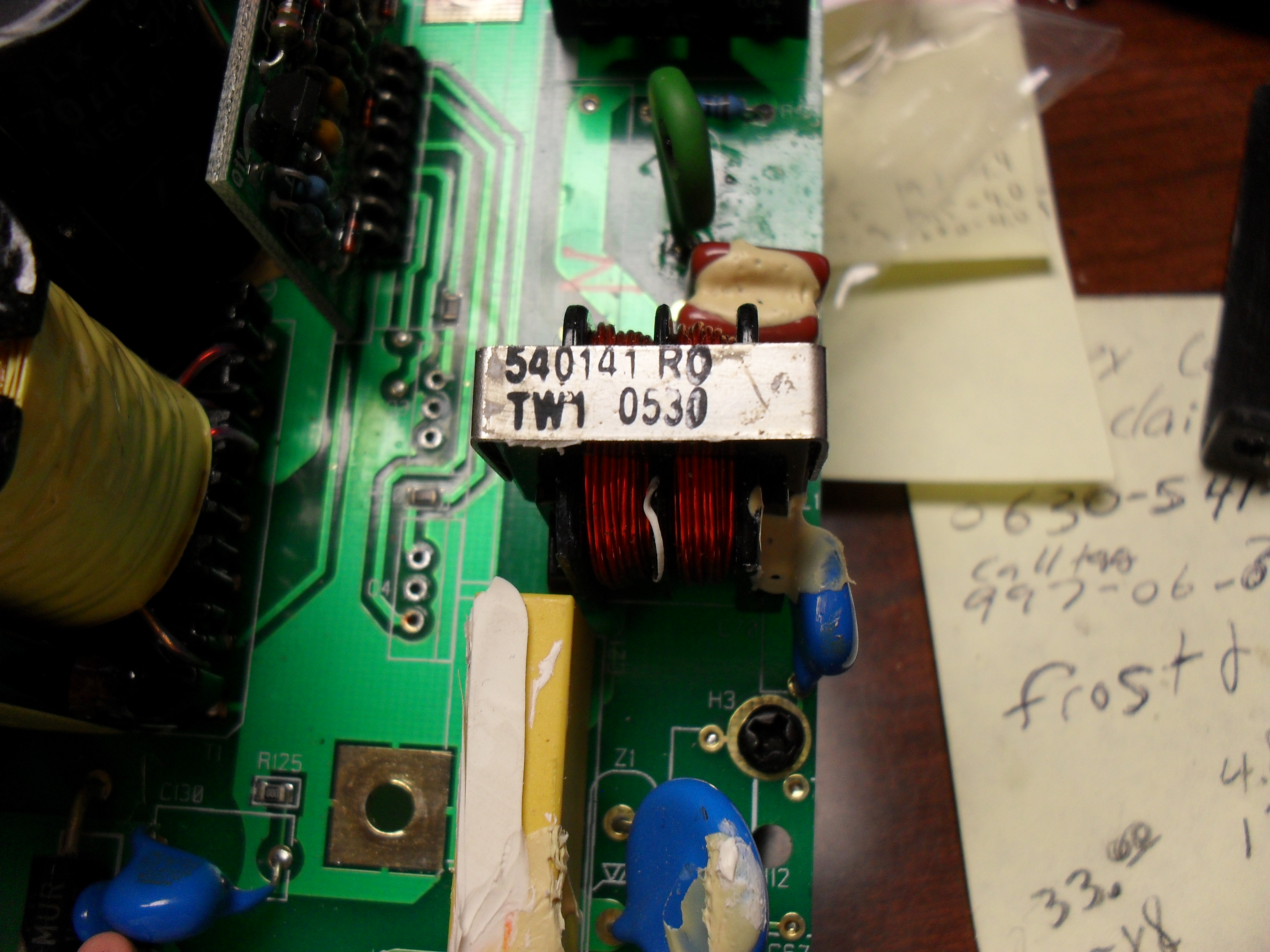

The pic shows a coil that is being used on the AC input stage. Each side of it is in series with the bridge rect. I am at a loss to honestly know what it is and what it is doing. Does not seem to be a transformer. Each side measures 0 ohms. Just wondering it's function.

The coil is part of a power filter circuit. I am confused! Is the fuse for the AC power input blowing, or is it between the power-supply and the amplifier??? Smps (switch mode power supplies) can be cery hard to fix!

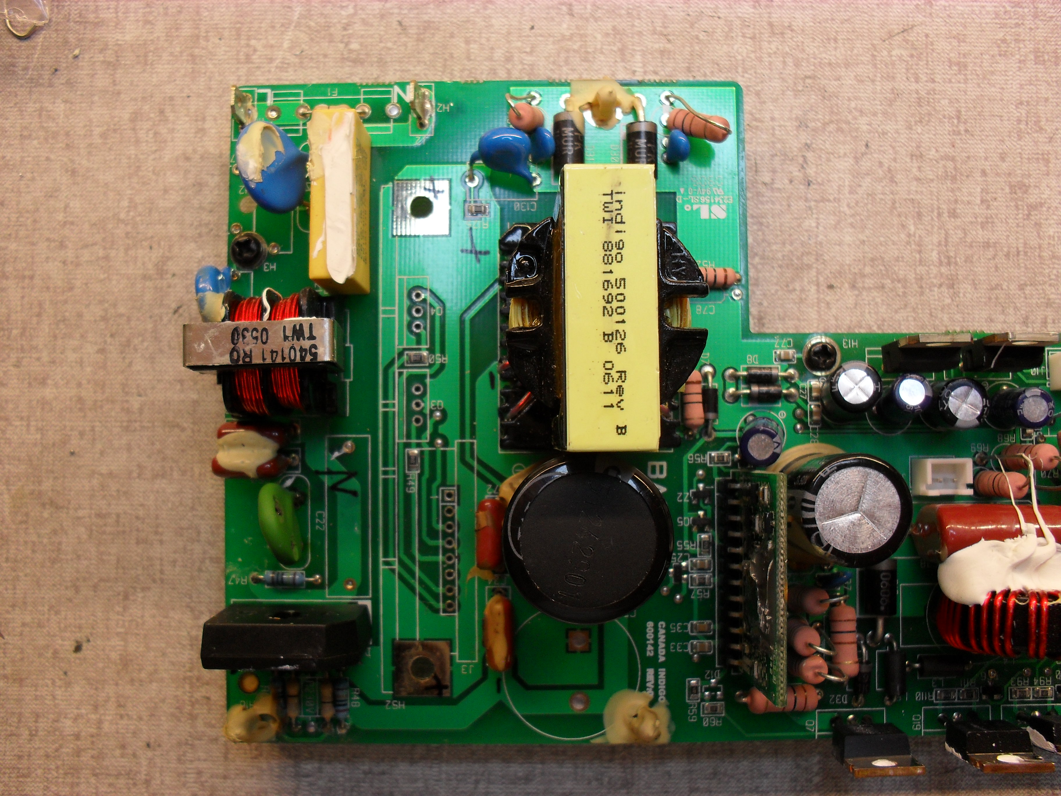

An smps will shut down (and not blow the fuse) when the output is overloaded. The problem is probably with the smps. Did you check the power supply's mosfet, or the main filter capacitor?

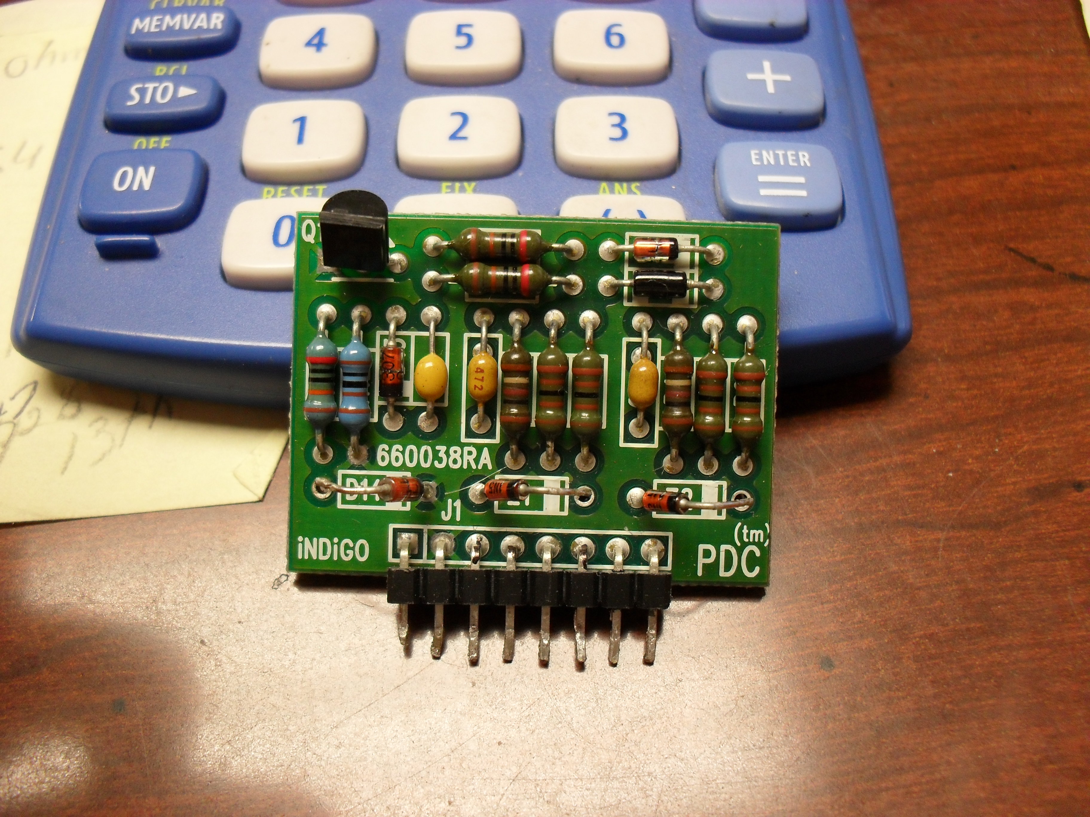

Yes, the main cap was removed and tested out of circuit. There are 2 mosfets that run is parallel best I can tell. One was toast and other was good. I installed just the one for testing knowing that i would not put any load on it. It immediately blew it and it's driver resistor. I was suspecting something on the driver daughter board but have pulled the zeners from that board and all are testing fine though I just used a diode tester for them. I am definitely getting educated on power supplies on this one...
Did you check the rectifier diode on the tranny's secondary?

If you want the full rezzy pics, shoot me your email via PM. I very much agree with you that the driver or PS anyway just seems to be a problem and the fact that the mosefets toast instantly points me directly to the driver board BUT how the heck do those mosfets get controlled? By looking at the driver, they surely do not get switched by any type of IC.
If you look at the pics, you will see that I have removed the mosfets along with the heat sink. In the two recent ones, the driver board is out. There is another daughter board that has a glob of epoxy covering something so that might be the mystery IC that is running the show.... However, it does not appear that it has anything at all to do with the mosfet drivers.
On the mosfet driver board, You can clearly see that of the 5 diodes, 2 are marked "Z1, Z2", and the others are Ds. I will assume that only 2 are zeners and the others are ????

I tested all the diodes with a DMM diode test. the "schottky" (??) diodes all test about .5V drop one way and OL the other so I am assuming they are not shorted out. As I understand, that is how you test a schottky, if that is what they are...
In the pics, you can see where the PS ends about where the large coil is and the output stage begins. Just not much going on in the PS and a bunch of stuff has already come of the board for testing. All the resistors, caps, etc have been tested. I did not remove the 2 large, fast acting diode but they test in circuit fine. Basically power comes in, makes its way to the bridge, then over to the mosfets and transformer coil and power cap. From there it goes out into the world. I have also removed several components on the output side for testing and everything is coming back fine.
IMO, I just cannot see a transient making it's way past everything in the PS and taking out the output stage. Amps commonly burn up from overdrive and that usually shorts the the output side. I think this one took a quick surge or possibly is just failed for no good reason. Only thing I have to go on is the PS mosfets are toasting and I do not even know how they work in this circuit....

Also, before reinstalling the single mosfet for testing, I checked the board for power to the gates. both were around 150VDC. I realize this could just be "surface voltage" and would possibly drop once a small load was there and probably should have tested that... My thought was if there was excessive voltage to the drivers, that would certainly kill the mosfet and possibly short it, causing what we have here. Problem is I just cannot find a bad component driving the gates...
In a smps, there is always a feedback circuit that monitors the voltage on the secondary of the transformer. The problem MUST be there, since everything on the HOT (high voltage) side of the power supply is fine.
Usually, there is an optocoupler that isolates, and couples the feedback circuit to the oscillator/mosfet driver. As far as I can see, there is no optocoupler, am I correct?
Optocouplers normally are a 4 or 6 pin dip chip.
