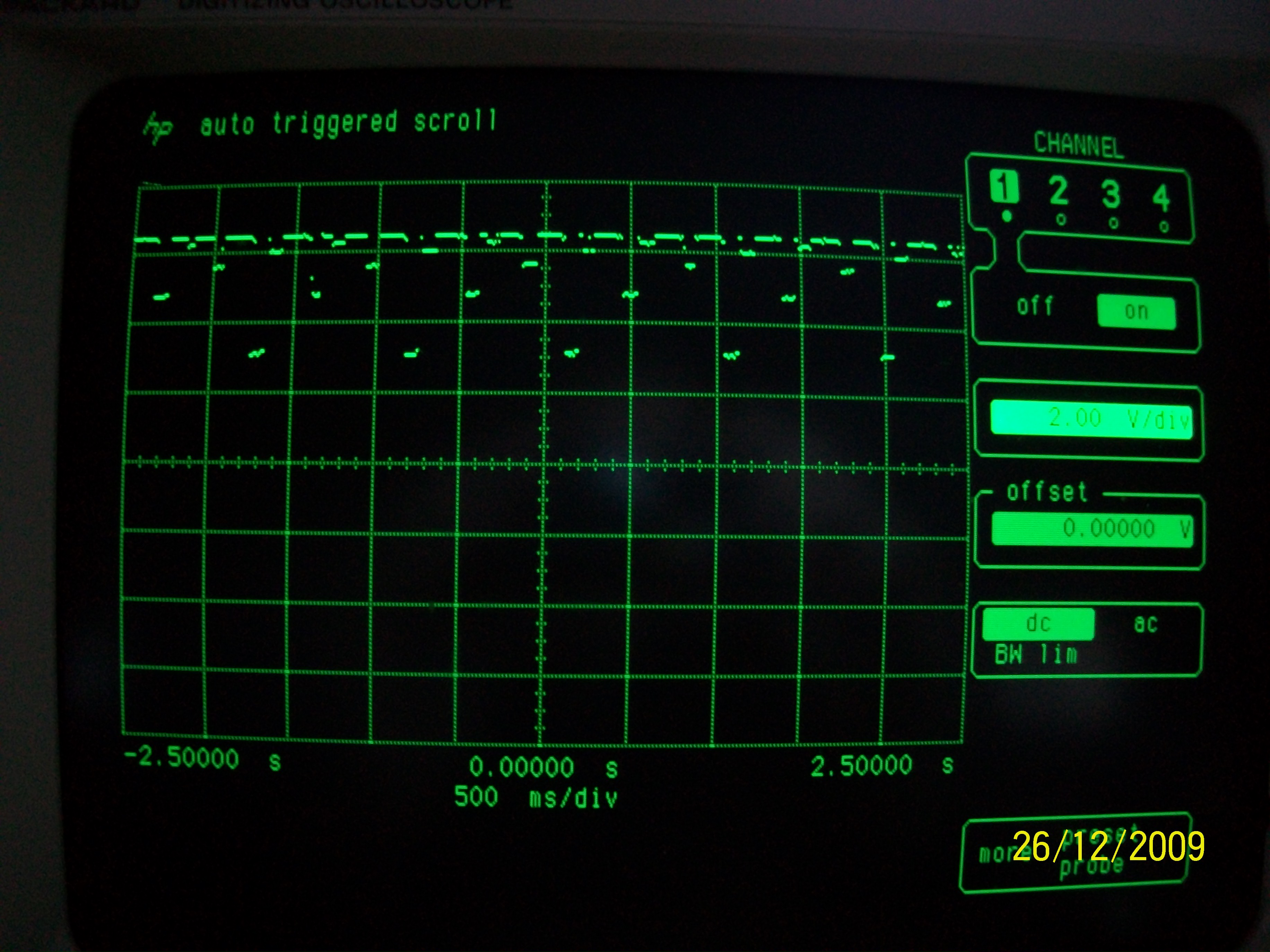

I've wired up an astable according to this:
555 Timer Astable Multivibrator Circuit; Pulse Generator Circuit
using a 555 chip.
R1 = 10MΩ, R2=1kΩ, C1=100µF, giving f=1.2Hz.
The thing is a get a really weird trace when connecting to the oscilloscope (see attachment) - 2V/div, 0.5s/div.
What could be wrong? I'm pretty sure it's wired correctly - have checked and double checked.
Many thanks,
Froskoy.

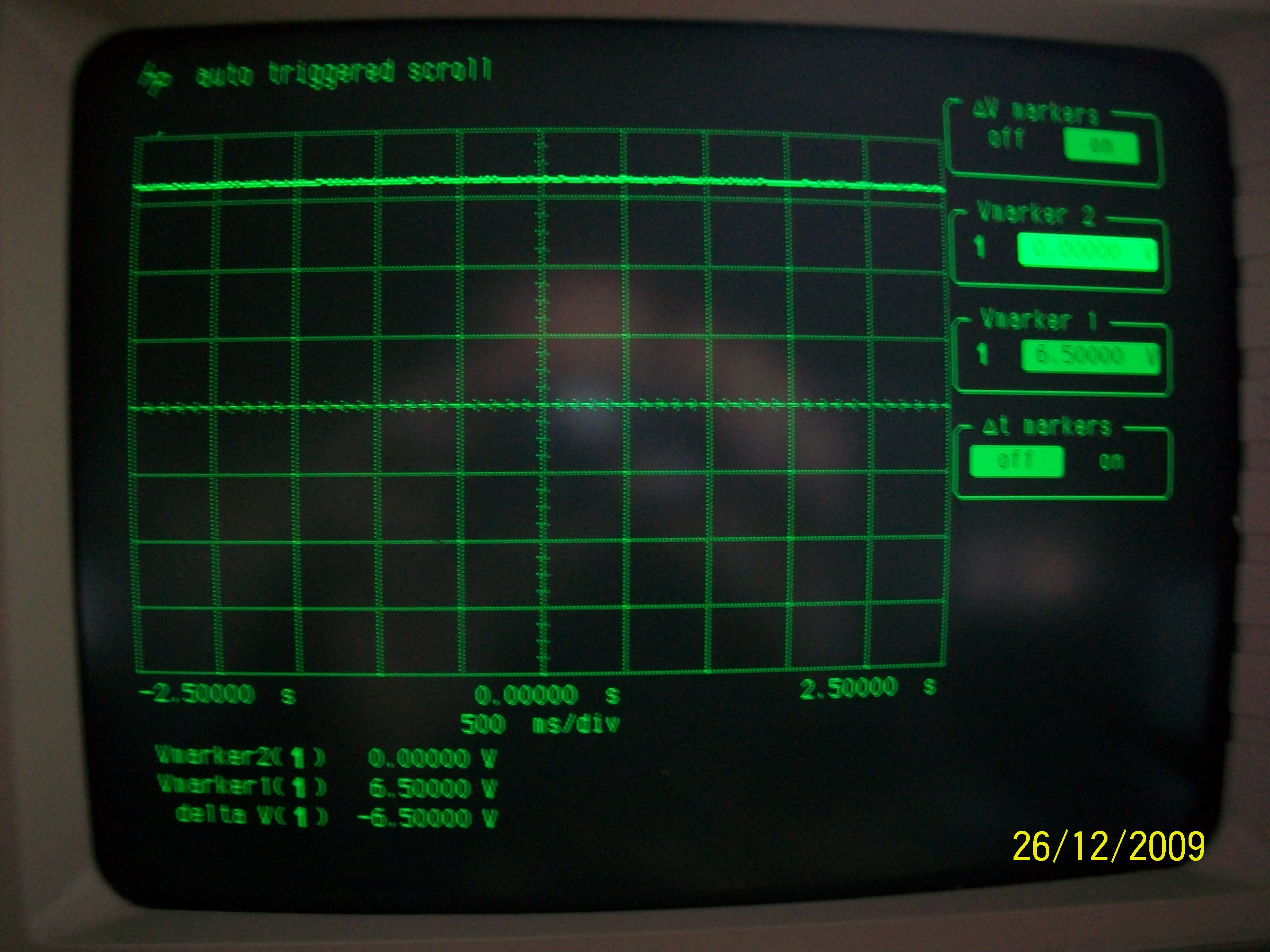

Thanks very much for the reply. Yep, taking output from pin 3, input looks like the attachment.
I'll swap R1 and R2 now and see what happens. Thanks very much for your help so far.

What is to be seen is normal. (time base too short. (500ms/div) :) )
With R1=1K, R2=10M and C1=100µF the resulting frequency is 0.001Hz.
On-time is 693,216ms and Off-time 695,974ms (duty cycle 49.9%).
For a frequency of 1.2Hz use R1=358.9K, R2=6.011M and C1=100nF, resulting in On-time 416.7ms at 50% duty cycle.
Boncuk
If you swap R1 and R2, you have a duty cycle of about 55% which should be easier to spot on the scope.
Then you will know if there are more problems to find.
