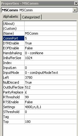

On the PC there is a VB6 application using MSComm control (properties in attached file RS232-02.jpg)

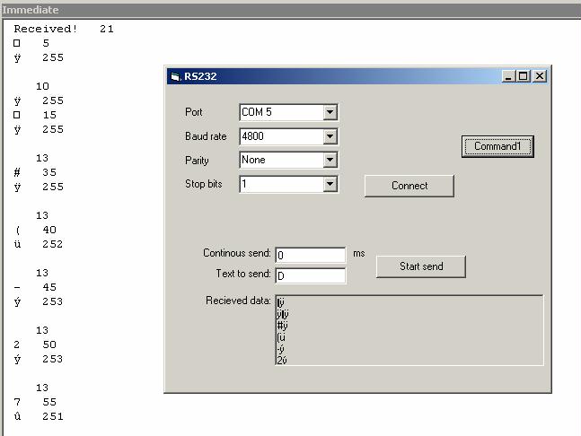

The first bytes of data are 0, 5, 255, 0, 10, 255, 0, 15, 255, 13, 35, 255, 13, 40, 252, 13, 45, 253, …
I encounter problems receiving the bytes with data “0”, zero.
Like you can see in file RS232-01.jpg all bytes are present except the three “0” bytes from position 1, 4 and 7.
Please notice that the software received only 21 bytes while the µC sends 24.
I suppose MSComm filtered these bytes out.
How do I tell MSComm to also pass bytes with “0” data to the input buffer?
I already tried with InputMode set to comInputModeBinary but with even worse result, mixed up data.

Easiest way is to convert all the data to ASCII, so send zero as the ASCII character '0', and 255 as the string '255' (or do it as hexadecimal ASCII) - this does mean you send more data, but it's fool proof, and avoids all the problems with RS232 control codes.

MSComm1.NullDiscard = false
I'd also set
InputLen=1
You currently have it set to zero which may work OK at the moment but will cause problems with some USB-RS232 converters.
