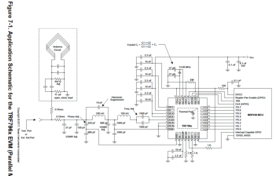

TI suggests a SoC solution. https://www.ti.com/lit/ml/slap127/slap127.pdf for higher f or https://www.ti.com/lit/ds/symlink/cc1201.pdf
or RFID Rx https://www.ti.com/lit/ds/symlink/trf7964a.pdf
Matching antenna impedance for low return loss with bandpass and bandstop requirements is the 1st step of a good 15 MHz Rx. Then a low noise front end amp with gain.
It may look something like this after you define better design specs for bandstop and bandpass..

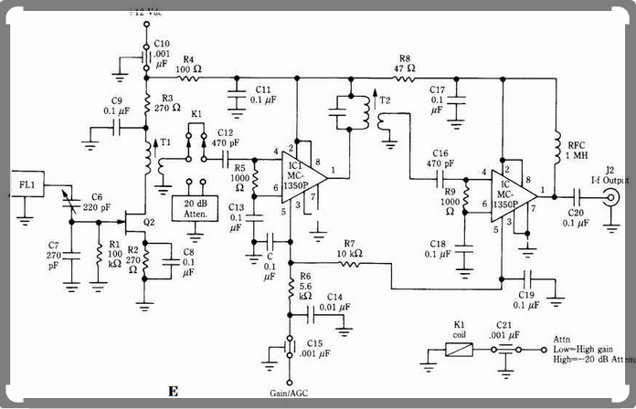

Secondly, look at proper radio receiver designs - the collector loads should be parallel resonant tuned circuits, not just chokes.
Also you need a bandpass filter (tuned circuit) between the antenna and the first transistor, otherwise that can be overloaded by any signal at any frequency.
I've not clue what that jumble of bits in the middle of the diagram is supposed to be!
Add resistors or chokes in the positive power connection between low level and high level stages, with each stage having it's own decoupling caps.
You have something like that on the collectors - but the bases are still fed directly from the non-decoupled positive power, so can pick up stray signals.
This gives a reasonable example of the first stage, the "front end" of the receiver; it's actually a converter so ignore the IC and later parts - but the first stage & RF bandpass filtering, plus the power decoupling, are good examples of what you should be aiming for.
