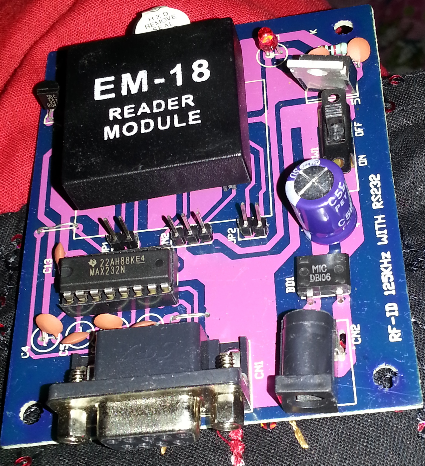

I am doing a project on RFID based shopping cart...but now am having a few problems. I am having trouble connecting RFID module to the microcontroller(AT89S52) am using.
The RFID module i purchased consists of EM-18 reader module and it has been connected to max232 and then to RS-232...so the module has rs232 output..now can i connect directly from rs232 to tx pin of microcontroller? or is there another way?
the following site says use max 232 and then to uc. but i have rs232 output..so how to?
i have attached the picture of my rfid module

You can buy (quite cheaply) USB/RS232 converters - simply use one of those between PC and your RS232.
Directly connecting the modules to the uC pins depends both on the voltages and polarities involved - if you check my PIC tutorials there's an example in the RF tutorial.
You don't hook the RFID reader to the TX (transmit) pin, you hook it to the RX (receive) pin. Also, if it is truly RS232, then you need a MAX 232 to convert it back to logic levels before going into the RX pin.
