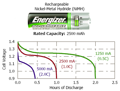

2.5 amp-hrs is a reasonable capacity expectation for a rechargeable AA.
That means it can put out half an amp for 5 hrs, or one amp for 2.5 hrs.
Since you are talking about an Energizer battery then why not see its datasheet on Energizer's website?
It works pretty well with a current up to 2.5A but is not so good at 5A.

If you use 2500mA cells in series, then the battery has a 2500mAh rating.
At 200mA the battery will last for 2500/200= 12.5 hours.
A circuit takes only as much current as it needs. Your robot will use a low current when it is stopped and will use a high current when it is accellerating up a hill.
