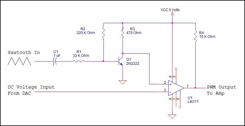

Given the choices as how to do what the OP ask there are likely a dozen ways to go about it. They mention using the USB port so Ill focus on that aspect. Given a choice I would go with a D to A converter USB driven. It becomes a simple off the shelf USB solution. Most of these devices include the drivers which are a pain in USB devices as well as D to A code solutions in most common languages including VB (the OP never mentioned a VB version). I would start with a device like this one. While that specific device is no longer available it has dozens of relatives out there extremely inexpensive. While the DAC functions are not calibrated adding a simple operational amplifier with a calibrated gain will get you where you want to be.
Next you have an analog voltage to convert to PWM to drive a LED (or whatever) lamp. I see PWM as a good choice. The attached circuit is a popular method in the rough of doing this. If someone wants to really nail it I would use a rail to rail comparator rather than the LM311 but for most applications the LM311 should work. That output could drive a transistor or logic level MOSFET depending on the load.
