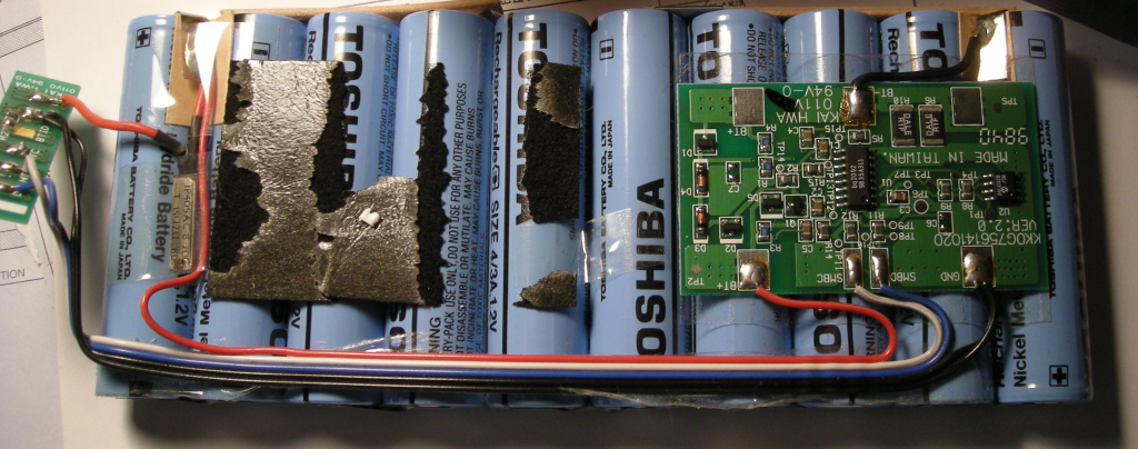

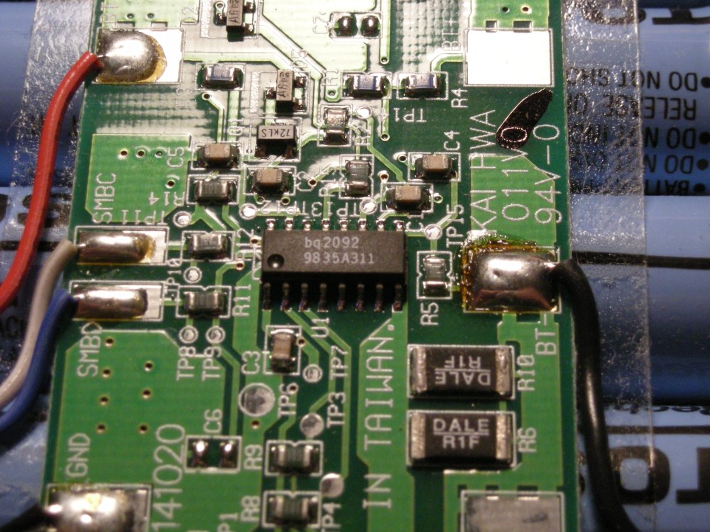

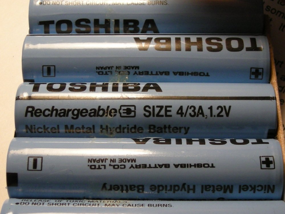

OK, I got a laptop at a garage sale for free (wasn't working), and brought it home. A couple tries got me a POST screen, but it died after that. Upon destruction, I found the battery pack was filled with Toshiba batteries (see pics). I know a lot has been asked about charging batteries, but I was wondering if anyone could help me with charging voltage/current. The batteries are arrayed for 12V output. There's a board on the batteries with a fuel gauge IC and a microchip EEPROM. The fuel gauge is supposed to be able to write to and EEPROM, along with pseudo-SPI comm over serial lines. For charging, would I just pump the voltage into the battery +/- terminals?

they are not lithium ion batteries are they?? if they are not lithium ion batts, they can be charged with just a normal battery charger that takes those kinds of batteries
oh, i just saw your second pic:eek: those batteries can be charged easily, although the circuitry makes it a bit more difficult???

You would apply a constant current to the +/- terminals or go through the connector that went to the laptop (red and black wires). It looks like the circuit monitors battery current via R6 & R10 on the negative side of the battery and voltage via R3 on the positive terminal. The case of the battery should state the capacity in mAh so just charge them at the stated mAh for one hour if they are fully discharged. Monitor the temperature and stop the charging if they get hot before the 1hr is up. You might also want to check for shorted cells with a voltmeter during the charging process. But why not just charge it via the laptop?

Wasn't sure about its history anyway. When I took it apart to see what was wrong, the hard drive adapter board connector was ripped halfway out, making me wonder if the laptop was dropped. It may have shorted and just never came back.
I'll try charging them @ output current & output voltage, check for bad cells, and watch the temp.
They may all be shot anyway, I'm getting a reading of 4V total across all 10 cells.
Thanks for your help.

NIMH batteries have a nominal cell voltage of apx 1.25V when "resting". During charging they can go up to apx 1.6V per cell.
The "4/3A" is the cell type. It does NOT mean 1.333 amp-hrs.
This type varies a lot in capacity. A quick search shows 2.8AH and 4.2AH batts on the same page.
Charging at a 1 hr rate is probably excessive, try a 2 hr at least.
It is difficult to charge these properly. They don't rise in voltage and thus the current doesn't drop off when they reach full charge. Your simple charge circuit won't be able to figure out when to stop charging and it will keep overcharging them, the overcharging will permanently damage them and they'll get quite hot.

So I could use the bq2092 to monitor the charge and instead of using the serial comm just tie the cut-off to the 100% LED output.
I think I have an 18V source, but I'd need more if I'm going to limit the current to the batteries. Back to what kchristie said, the board does have current limiting resistors on it. I've never seen "R1F" as a resistor designation for SMDs.
Based on **broken link removed** it looks like they're 4Ah batteries (The notebook was a Toshiba T-something or other, but wasn't a T2500.)
