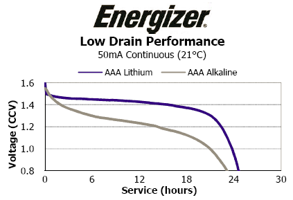

Energizer make lithium non-rechargeable 9V, AAA and AA cells that outlast alkaline cells.

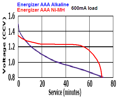

Ordinary Ni-MH cells have a higher voltage at the end of a discharge than alkaline cells.
New Ni-MH rechargeable cells come pre-charged and have much less self-discharge than before. But their capacity is less.
Lithium-ion and lithium-polymer batteries are extremely dangerous because they catch on fire if over-discharged or over-charged.
