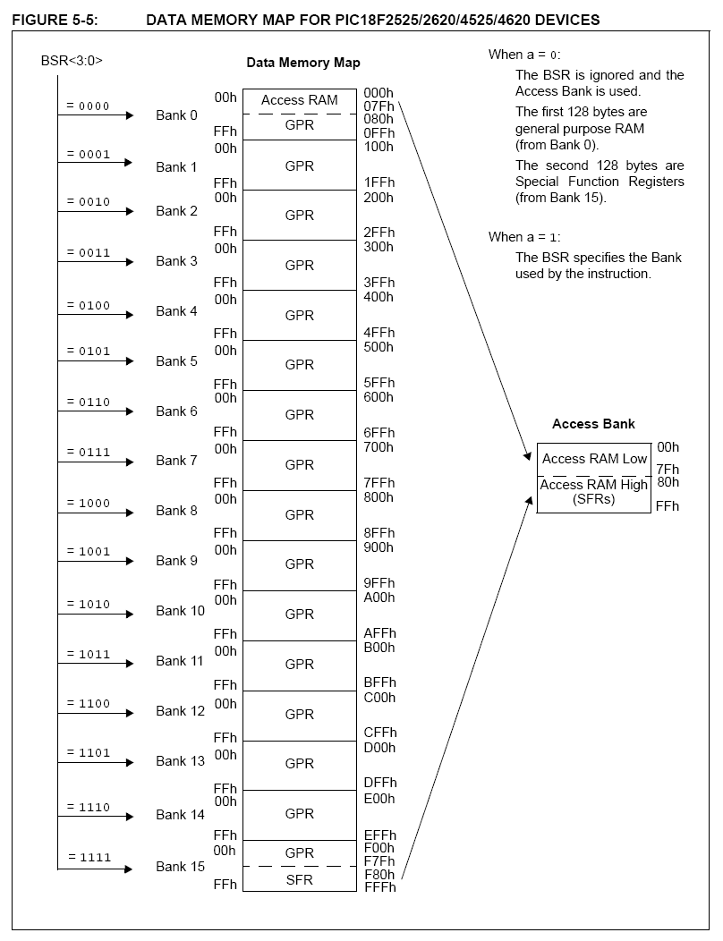

Please look into the Datasheet, Especially the Access Bank. Shortly, it takes all SFRs and 128 GPRs and put's them into separate address space, so that no Bank switching is necessary (if 128 GPRs is enaugh).
Yes... I have been thinking and simulating all day...
I am thinking of an extreme case... Where 128 registers are not enough... My PIC is supposed to send packets over an RF link... And a packet means a lot of data with CRC and overheads etc.
What I found was that the linker build fails if a variable or a part of it declared in one udata section overflows from the bank it is currently being defined in into another bank...It is not allowed....
So one has to manage variables in such a way by starting the udata at the begining of the bank so that maximum size of variables can be declared. If I start at FE, I can have only teo bytes.... One at FE and the other at FF. Should I try to define a 3rd byte, there is a build fail.

ALL systems have to manage their variables, either at design time or at run time - if you're using a buffer you should know the size required BEFORE you write the program, and allocate it accordingly. If the buffer is large enough to overrun the size of one bank, then allocate the buffer in it's own bank - this means you only have to bother with bank switching code when dealing with the buffer.
Look and think about this picture.
