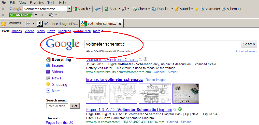

Well, lets see what Google can do...
Not difficult is it?
