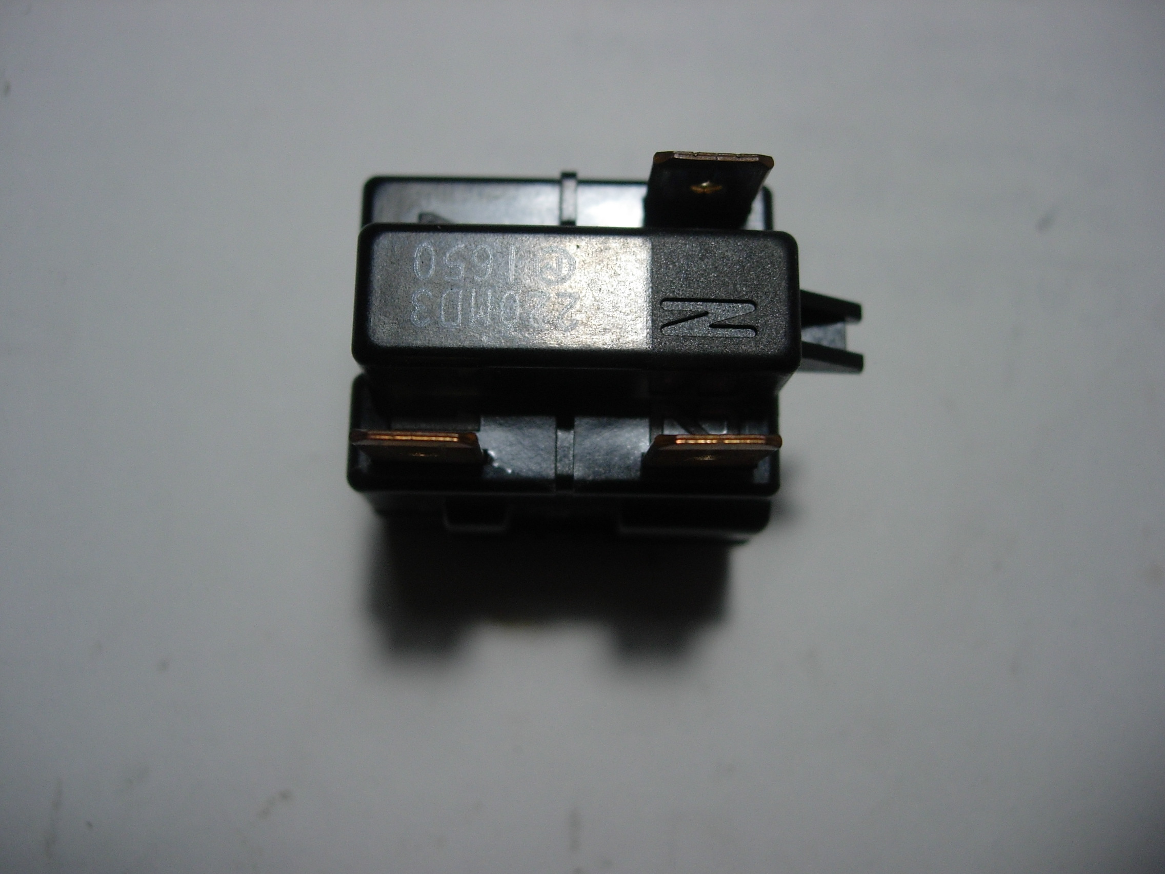

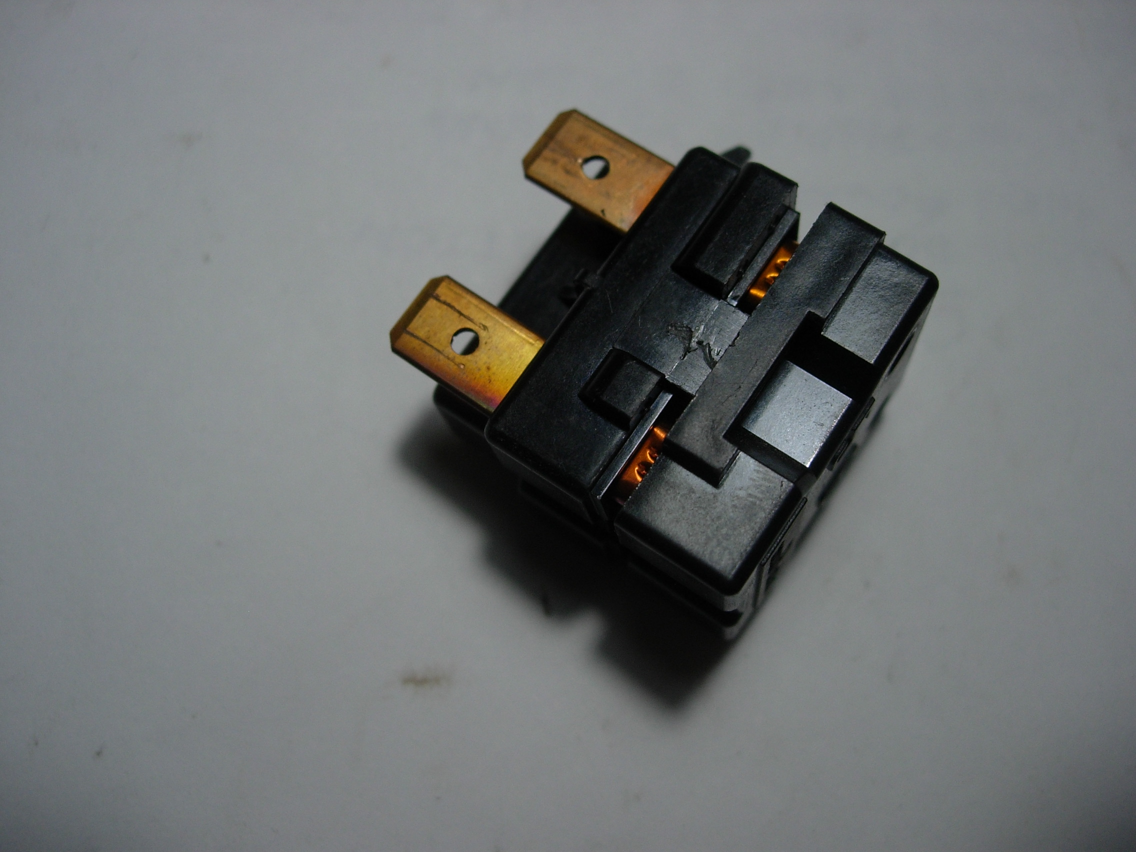

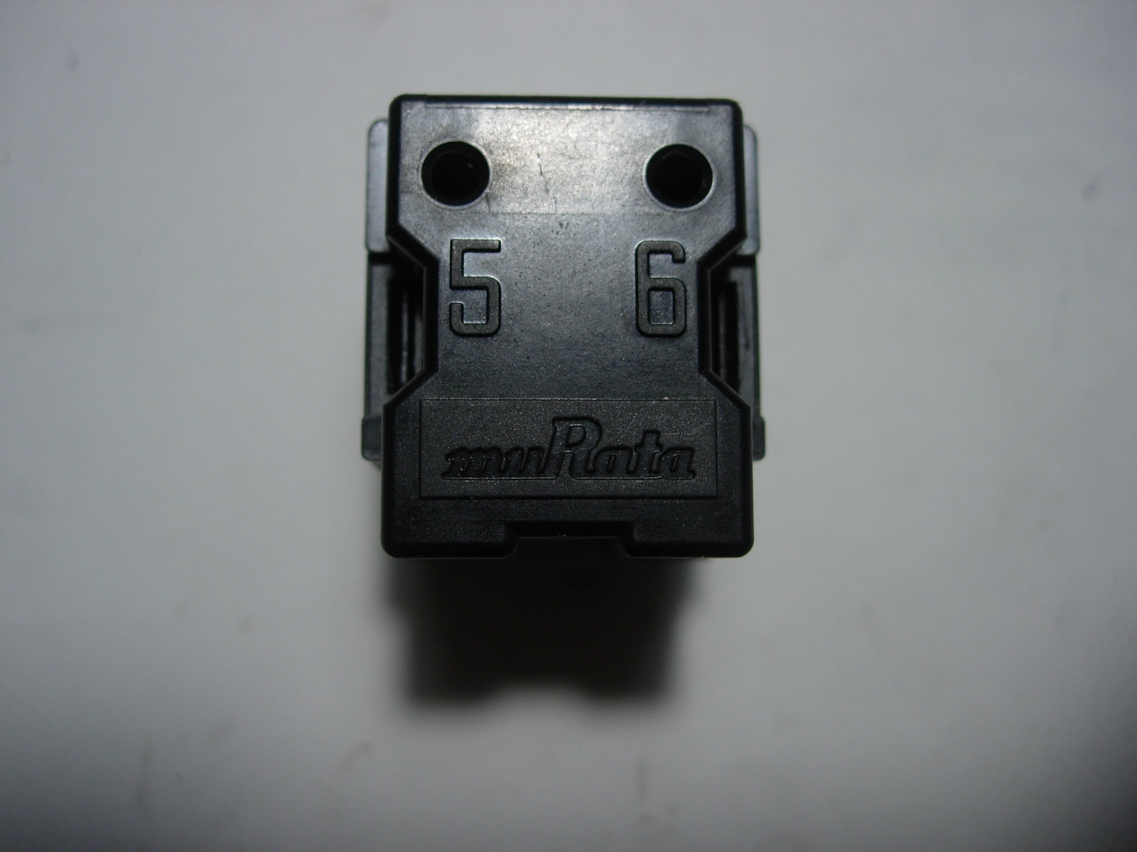

Nowadays they have solid state starter relays in these and one of mine stopped working . definately the starter so i am ordering some new ones .
Its marked as
PTH AS
330M3555
07 M 70P
So the ones that are available are 12 Ohm and 33 Ohm so I am wondering which I will need as my markings do not show the resistance that I can pick . The ebay reference to the sort of thing I am choosing from is
https://www.ebay.com.au/sch/i.html?...er+Relay.TRS0&_nkw=PTC+Starter+Relay&_sacat=0
Can anyone advise me on this please ?
Also any suggestions on something I can use temporarily , Would a start capacitor do for a while to keep my beef frozen?
Hi, can you enclose a picture so it can be better identified, what about the make and model of the appliance.
As for the beef, that's what friends are for, either distribute it amongst there freezers or feed them all :)

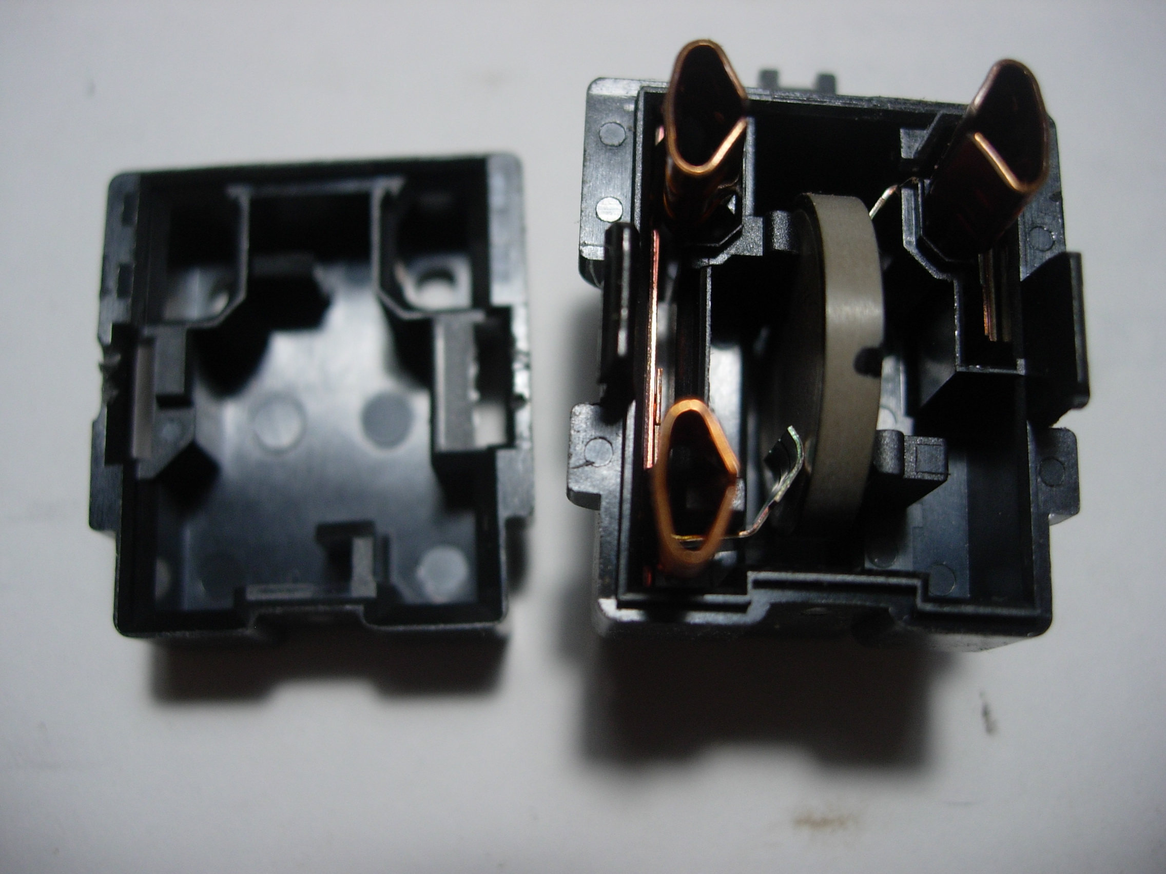

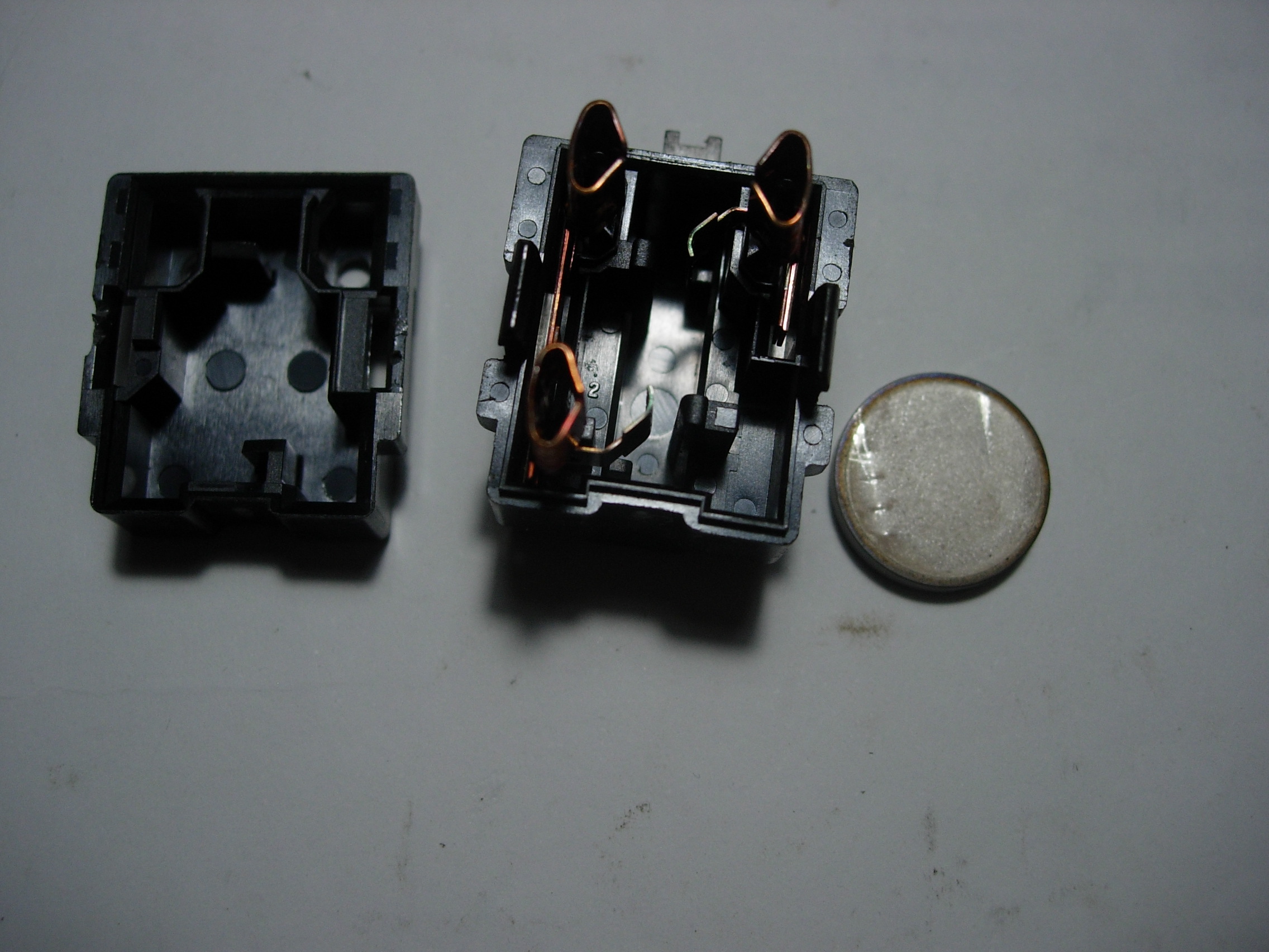

With PTC relays the resistance is at 25Deg C which goes hi when heated as its to give about a half second pulse of current to the start windings. There is also a Max voltage & current rating. For a temporary fix try dismantling it, if the disc inside isn't shattered try flipping it around. Also what is the line voltage where you are?

240 Volts I have new ones coming of 22ohm and 33ohm . Original is completely gone . How can I attach a start capacitor to the motor temporarily?
Don't even think about using a start capacitor. The motor has to have a half second pulse on the start winding to kick start.

330 is code for 33Ω
