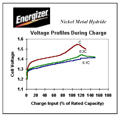

Look at the voltage for the Ni-MH battery. Its voltage DROPS when it is fully charged.
Use a Ni-MH battery charger IC that knows when the battery is fully charged and shuts off the charging so it doesn't get overcharged. The IC measures the voltage and detects when the voltage stops increasing, or when it drops. It also senses the temperature rise when a battery becomes fully charged. A timer is used as a backup. Some charger ICs can be set to discharge a battery before it begins charging it.

Hi audioguru when we talk about 1.2V AA NIMH batteries my ones when it’s fully charged its reaches to 1.35V-1.4V.So its better to reference a voltage about 1.3V.when its passing 1.3V it stops the operation. If I need more can do a very small trickle charge….or whatever….what do you think.???
A battery is charged with current, it is not charged with voltage. So you can measure the voltage of the battery as it is being charged.
Look at my graph, 1.3V is too low to stop charging because the battery cell is only just beginning to charge. Depending on how much is its charging current 1.4V is close to being fully charged.
From the schematic above, just a voltmeter across the batteries will do right? How if the battery is being charged by the adapter/regulated power supply directly via a diode? Then the voltage appear at that point is Vin-0.7 V.
For energizer batteries it will be 1.4V fully charged. So better cut off charging reaches upto that level…I’m using a comparator Bcuz hard to find that MAX712 IC in my place to detect more options……
