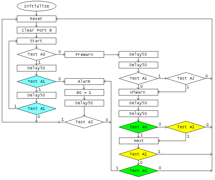

This is my setup:
Im testing my program, by puttin in DC current in RA0, RA1 and RA2. what the program is supposed to do is send an output through RB0 when there is no voltage in RA0 and RA1. It worked fine at first.
But i added increased the delay time, so that RB0 would sent an output only after a certain time. with this changed code, RB0 is not sending any output.
I changed back the code to the 1st one, but now PB0 doesnt send an output.
I highly doubt there is anything wrong with the PIC, because i can download programs into the PIC from the computer, but i could be wrong.
does anyone know wut do be happening here?

		LIST	P=16F877			; Indicate to the compiler which micro to use
; Registers mem positions
TRISA	EQU		h'85'				; PortA control regsiter
TRISB	EQU		h'86'				; PortB control regsiter
PORTA	EQU		h'05'				; PortA values
PORTB	EQU		h'06'				; PortB Values
STATUS	EQU 	h'03'				; Micro Status
CountM	EQU		h'30'				; Used for delay
CountL	EQU		h'31'				; Used for delay
ADCON1	EQU 	h'9F'				; Analog to digital control register (used for digital/analog control)
		ORG		h'000'
		BCF		STATUS,6
		BCF		STATUS,5			; Make sure we're on the page 0
		CLRF	PORTA				; Initialize port A
		CLRF	PORTB				; Initialize port B
		BSF		STATUS,5			; Change to page 1
		MOVLW	h'06'
		MOVWF	ADCON1				; Make the port A as digital input
		MOVLW	h'FF'
		MOVWF	TRISA				; Set all pins for PA as inputs
		CLRF	TRISB				; Ser all pins for PB as outputs
		BCF		STATUS,5			; Come back to page zero
; Step 8
Reset   CLRF 	PORTB				; Clear all the outputs
; Step 1
Start	BTFSS	PORTA,0				; Check for laser 1 beam not broken
		GOTO 	PreWarn				; If broken check others
; Step 2
		CALL	Delay50				; Wait some time between readings
		BTFSS	PORTA,1				; Check for beam L2
		GOTO 	Alarm				; L2 Broken goto alarm (STEP 4)
; Step 3
		BTFSS	PORTA,1				; Check for beam L3
		GOTO	Reset				; Reset machine (L3 broken)
		GOTO	Start				; Goto begining (L3 not broken)
; Step 6
PreWarn CALL	Delay50
		CALL	Delay50				; Timer
		; Check L2
		BTFSS	PORTA,1
		GOTO	HiWarn				; Goto step 7 (L2 Broken)
		; Check L3
		BTFSS	PORTA,2
		GOTO	Reset				; Reset System (L3 was broken)
		GOTO    HiWarn				; else goto step 7 right below
; Step 7
HiWarn	CALL 	Delay50
		CALL 	Delay50				; 100 ms delay
		; Check for both L1 and L2 broken
		BTFSC 	PORTA,0				; This is L1
		GOTO 	NEXT
		BTFSS	PORTA,1				; This is L2
		GOTO	Reset				; Reset system. Both broken
		; else continue checking right below
		; Check for both L1 = Not Broken AND L2 = Broken
NEXT	BTFSC	PORTA,1				; This is L2
		GOTO	Reset 				; Reset system (the condition was not accoplished) - L2 not broken
		BTFSS	PORTA,0				; This is L1
		GOTO	Reset				; Reset system (the condition was not accoplished) - L1 broken
		GOTO	Alarm				; Condition accoplished goto alarm (Step 4)
; Step 4
Alarm	BSF		PORTB,0				; Turn on alarm!!
		CALL	Delay50
; Step 5 - Check for an adult command to stop alarm
		BTFSS	PORTA,3				; We received a command from the receiver to stop alarm??
		GOTO	Alarm				; Goto step 4 (we didn't recive the stop command)
		GOTO	Reset				; Reset Micro
; Delay of 50 ms for a 4 MHz XTAL
Delay50	MOVLW	h'AD'
		MOVWF	CountM
		MOVLW	h'5F'
		MOVWF	CountL
		DECFSZ	CountL,F
		GOTO	$-1
		DECFSZ	CountM,F
		GOTO	$-5
		RETURN
		END							; Program end here

I looked at this code briefly a few times, and each time got afraid after being lost in the countless redundant bit tests, and decided I would come back later. :p But I finally decided to make a flowchart based on your code (next time, you should make a flowchart first, and make your code based on that). It has some issues. I have highlighted the affected areas (see attachment below).
1: You say you are putting 5V DC into each of the A0, A1, and A2 inputs, and it never activates. Well, yes, according to the flowchart, after the Start, it tests A0, sees a 1, delays, tests A1, sees a 1, delays, tests A1 again, still sees a 1, and goes back to Start. So your program is behaving exactly as expected with those inputs producing no output.
2: Blue - You test A1 twice in a row. Your comments lead me to think you actually meant to test A2, but your code does A1 again.
3: Green - You test A0 twice in a row. Although there is maybe a 0.000001% chance that you could actually make that pin change states between the two tests, why test it twice?
4: Yellow - The A1 tests are mutually exclusive. The first one says if A1 is 0 then reset, otherwise continue. The second one says if A1 is 1 then reset, otherwise continue. Again, it's going to be next to impossible to switch states that fast, so this is an obvious error.
5: Why is it such a long path to get through the right side of the chart? Say that you test A0, get a zero, and wait. Then you test A1 get a 0 and wait. Why then do you test A0 and A1 two more times? While it is definitely possible for them to change states after 0.2 seconds, why test again and again, when you already just tested them?
6: I just noticed another possible mutually exclusive condition after I made the picture, so it's not colored in. The first test of A0 right after Start enters the right hand side when A0 is 0. From here, it only makes it to the Alarm section if it turns to 1 within 0.2 seconds (4 x 50ms delays). You would have to know exactly when it enters this branch of the program, and you would have to toggle it pretty darn quick if your reflexes are even that good.
7: Lastly, if you want to see if your alarm output B output will work (it should), set A0 = voltage, A1 = ground, and A3 = ground. This should allow it to enter the Alarm loop and stay there. You should be able to see the output on B0. After confirming this, change A3 to voltage. At this point the program will loop back to reset. You may see B0 briefly flicker at this point, or it may be too fast to see, but it keeps looping to Alarm and Reset. At this point put A1 = voltage. You should now be in the small loop in the left hand side of the chart that was described in issue 1. If at this point you set A0 to ground, the states it flows to are pretty much irrelevant in their present form.
