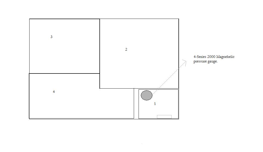

We have a clean lab (shown in picture)consists of 4 different rooms and each having "Series 2000 Magnehelic Differential Pressure Gauge" 0-6 mm of water range.

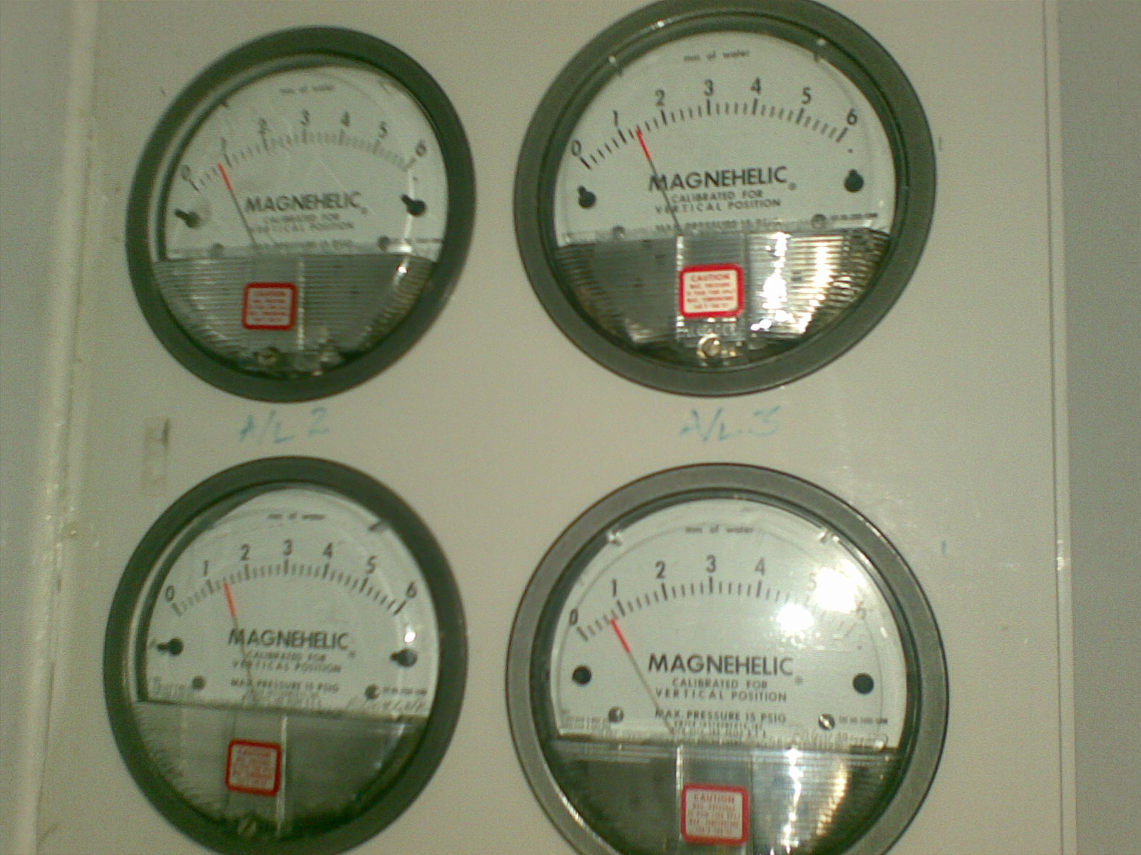

As these 4 are differential pressure gauge, so we are having 5 pipes(4 + 1 common reference)of input going inside them.(picture 2)

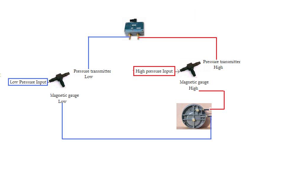

Now, I want to install one pressure transmitter for one of the four rooms without disturbing the current system. So, my question is that can I put a "t" or "y" coupler at input side of one magnetic pressure gauge so that one input goes to magnetic gauge and one goes to pressure transmitter.
My configuration is shown in picture-3.
Anyone has idea about this???

There should be no problem provided that your extra pipework to the pressure transmitters does not have any leaks.
