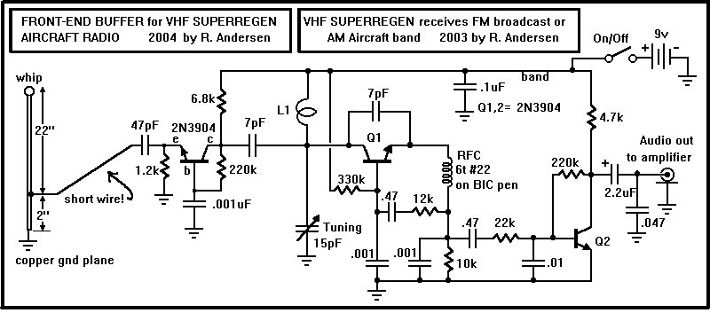

i need a 27MHz regenerative receiver for R/C model airplane.
This circuit will work.

No, that's for picking up commercial aircraft voice radio on VHF.
You should really use a professionally build radio for an RC aircraft, it's essentially a 'flying bomb' and losing control of it could be very dangerous. They cost very little these days and are incredibly small, you mustn't attempt to use a regenerative receiver they aren't reliable or selective enough, professional ones are superhet and crystal controlled.

Presumably the 'kit' was for a toy car (not a model car), it's not suitable for a plane, and shouldn't be used for one.
There are plenty of superhet circuits about, just google for them - but they are obviously much more complicated than regens - but that's why they are so much better.
