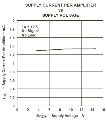

You can look on the datasheet for whichever opamp you are using.
The datasheet for the TL071 and TL081 opamps show that the supply current increases from 1.3mA when the total supply is 7V to 1.35mA when the total supply is 29V.

Hi Audioguru,
Thanks for that, i have to admit i neglected to notice that on the data sheet.

Another point: if the bias for either of the opamp's inputs are derived from the 12V (e.g. a resistive voltage divider), then there will be a corresponding shift in the quiescent output voltage. If the bias is derived from a regulated voltage, then there will be only a slight shift. This is due to the opamp's Power Supply Rejection Ratio (PSRR), also listed on the spec sheet.
