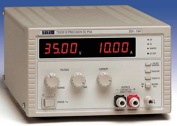

Hi everyone
I know it's a very noob question, but nobody could explain me the concept clearly, and to make things worse I love electronics, but my Math is really dumb.
How can the current be regulated? I know IC's to regulate the voltage, and (as far as I know) the current depends of the load connected to the circuit. But how can the Power supply of the picture regulate its current?

First on your power supply question. It really doesn't 'regulate' the current but rather limits the max current based on the adjustable pot. It's to protect circuit components in case something is shorted out. If the load tries to draw more then the set max current the power supply starts to decrease it's output voltage to keep the current draw at or less then it's setting. That make sense?

Thank you Lefty, I think I got it with the power supply!
