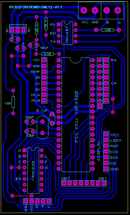

Hi, I have a controller board i made for PIC18F4520. The regulator i used is 7805. The problem is that it gets really hot. I dont know why this happens. Can anyone suggest me how to debug this issue. Also what are the values suitable for the Caps for 7805.
I am giving in 9V and getting out 5V.
My PIC is running on HSPLL mode (40MHz)
Are you sure it is connected the right way round? That is one of the most common causes of a 7805 getting too hot.
Post your circuit so we can see what you are (apparently) doing, then we can help more.

The regulator may be self-oscillating - if you don't provide capacitors on input and output - and close to it.
Hi, sorry for not being so very responsive. I have attached the PCB file ( i dont have schematic ). There is a MAX487, Nokia 6100 screen, a Demux IC and the PIC controller. The regulator gets hot even if everything is detached other than the controller.

The circuit actually works fine so i am assuming its connected alright. I get 5V output from the regulator's 3rd pin.
I have not connected any traces from regulator with my PIC controller IC other than the two VDD's and VSS's and attached a 0.01uF cap on one side.
I have caps on the regulator (both 10uF)

You also need a 100n to stop it oscillating and it must be very close.
Is the 9v dirty? Is it AC or DC? Is the micro getting hot? Are there any other components or lines or wires or resistors in the circuit?
i have a 0.1uF cap close to the the controller. The 9V is DC. Sorry i do not know what dirty means :p
There are a few resistors, 10K, 470,120 and one resistor pack for 10K to pulldown portB. The controller it self is not getting hot nor any other components.
EDIT: If you are talking of placing 100nF close to regulator, i have an polar 10uF cap there on both Input and output.
Check your current drain, that 7805 is dropping 4V by whatever current you are pulling. If you are pulling 100mA the Power converted to heat is 4 * .1A to give .4W etc. So it will develop some heat. If u want cool operation use a switching regulator.
10u will do nothing to prevent 1MHz oscillations. 10n is not high enough. The cap has to be right up against the regulator lead. Dirtly 9v means the input may be half-wave or poorly smoothed or way over 9v on no-load. It may be 15v on no-load and drop to 9v when current is taken. These are all the possibilities that causes teh regulator to heat up. The regulator may not be heatsinked fully.
The heatsink is your problem. The regulator will get hot, no matter what the current, if it not heatsinked. The caps must be 100n not 10n.
