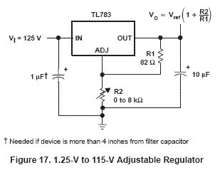

High voltage regulator.
Hi Carnivore,
There's a voltage regulator which can handle the 45 volts.
If you choose 240 :ohm: for R2 the output voltage will be 5 volts.
on1aag.
An LM317 would even do it providing you don't short circuit it and if you're worried about that add a resistor in series with the regulator (about 100:ohm: or so), something that will drop the input voltage to a safe level when it's passing the short circuit current.
