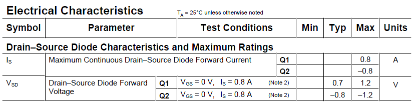

I'm using FDC6420C in my H-bridge, which has the following built-in diodes inside:
Are they ok?
I dont have a bypass capacitor at the VCC (its a 5V regulator connected to the output of a mains-to-7.5V buck converter), only a 10uF capacitor.

Those are built in MOSFET protection diodes, they do not prevent spikes from the relay coil to contamine the Supply line. (Did you looked at my blog?). You must use a freewheeling diode on your relay.

The built-in diode in the MOSFET just protects the N-ch MOSFET against possitive voltage from source to drain, am I correct? (same to the P-ch one).
And it doesnt protect it against high positive voltage from drain to source, as happens when the MOSFET is switched OFF, yes?

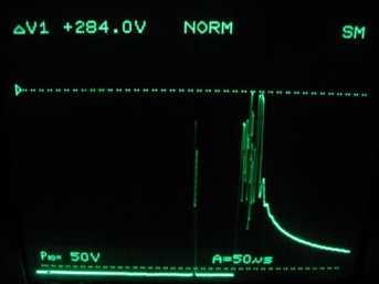

These spikes happen because the switch oscillates between allowing current flowing and disallowing current flowing several times?
What makes the voltage eventually decreasing in a form of a capacitor's discharge?
About adding a protection diode as was advised in your blog, how do you connect protection diodes to a single-coil latching relay, that current flows through it in both directions?
The intrinsic diode will conduct in this direction, but in a unipolar switch there isn't such a current to "protect" from.
Correct.
(An H-bridge comprises 4 MOSFETS drives that relay).
An H-drive uses 4 diodes, one across each transistor. You probably have already seen them. In some designs the intrinsic diodes are used and you won't see separate devices.
It helps me to call the diode the "intrinsic diode" to remind me that the diode built in to a MOSFET may, or may not, be suitable for other purposes even if it happens to be located conveniently. The data sheet tells me what use I can make of the diode.
