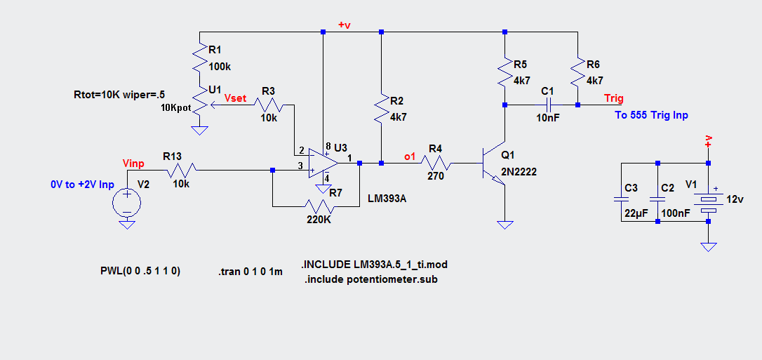

I'm working on the project for my uni study and part of it focuses on electronic solution. The problem is I'm a real beginner and just managed to solder my first kits. Anyway, I'm trying to trigger a relay (or something similar) with a very low voltage available (approximately 0.8-2V) and even smaller amps (in fact, the power generated comes either from a small motor originating from science-toy wind generator or from a lemon/potato). I have constructed and tested a kit called "monostable switch" and all works perfectly fine (an external button upon closing the circuit sends a signal to that kit, which then opens a relay and sends further connection signal). The problem is it is simply triggered by an actual closure of a circuit, not by a power generated by that potato ;)
I want to have a possibility to demonstrate that in case potato or motor does not generate even a substantial amount of current, the button will not work, thus closing the circuit which then triggers external function.

Is there possibly any device/relay, which would be powered by external battery but will act (open/close relay/circuit) upon sensing of a current from some other input device?

hi and welcome,
The device you are looking for is called a 'comparator' , a common type is a LM393 IC.
Are you able to get a LM393 or LM339...??

I will post a circuit diagram within the next 24 hrs, tell me what voltage your existing circuits are being powered by.???
My monostable switch kit requires 12V supply (555 Monostable Switch MAP 422 - N32FL). Thank you!
Its possible to trigger a 555 monostable directly from the output of a LM393, you dont really need a relay, would that be ok.??

This works OK, can you follow it OK.?
Look it over, any problems ask..:)
Note:
There are two comparators in the LM393 IC. so you could make two circuits for different 555 if required.
The 10K SET pot allows you to set the trigger voltage between approx 0V and +1V

From his description of his 'voltage sources' ie: potato/lemon batteries I would have thought a LM393 would be his best option, also IIUC he wants an adjustable threshold.?

Using 12Vdc to power the 555 and LM393 and using a potato voltage to drive the LM393 input pins.???
Yes, you are correct. 555 already does what I want (it has a relay) but just with a simple button pressing (or external input connection, which works simply by joining both together, well like button does ;) ) but obviously I want that LM 393 (or anything similiar) to trigger an input button in 555 but only when there is lemon current present.
In easier description, I just want to operate connection (I want to start a PC with it), which as you should know has a button and two wires to PC's motherboard. Those wires will send a signal when connected together (in that case a PC button). I want to trigger that start but only when lemon is connected. In fact, additionaly I am intending to incorporate additional small power generating device (a motor from windmill toy) and connect all together (plus small led indicators showing there actually is a voltage present from those sources, already have them), so when someone wants to start a PC, a lemon and/or motor needs to generate power. Otherwise, if they don't, the button will not work. It can have separate buttons, so one start button for lemon, one for motor or possibly only one but all joint together.
