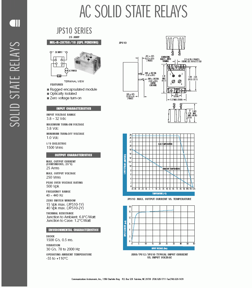

Unless I'm mistaken, M28750 is only part of the military part number for the relay. Do you have the whole number? If so, search google on the whole string. You could also check out www.teledynerelays.com for more information.

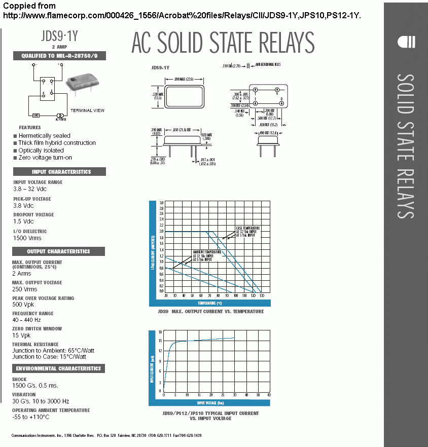

Here is another one.
