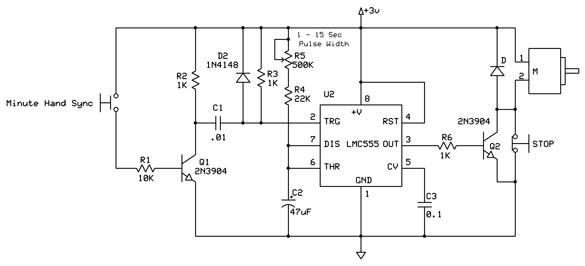

I am looking for an electronic kit to control a 3v gear motor (such as a Tamiya #70103 or Velleman #KNS7) in a small action clock project that I want to build.
The kit is to have a relay that will turn motor on, which will cycle mechanical action till a micro switch is triggered, stopping/resetting the motor's cycle.
This will have to accurately trigger every 60 minutes.
As I am very much an electronics beginner, I would be grateful for some recommendations. Thanks!

While I do not have the total design as yet, the DC gear motor that I intend to use will run on a couple of AA batteries. It will probably cycle for 15-20 secs. at about 2 RPM.
While this project is intended to be a clock, there will be a separate clock insert. The motor will drive some mechanical action on the hour, go through the cycle and reset for the next trigger (much like a cuckoo clock).
To maintain accuracy, over long periods (days...weeks...months), I think you're going to have to somehow link your motor control to the minute hand on the clock insert. A STOP switch, a trigger linked to the minute hand, monostable multivibrator with a time period long enough to move the motor past the STOP switch. The monostable will be tricky at <3V, because the motor will pull down the voltage of the AA batteries.

Something like this might work. According to the datasheet an LMC555 will work down to 1.5V
Ken
