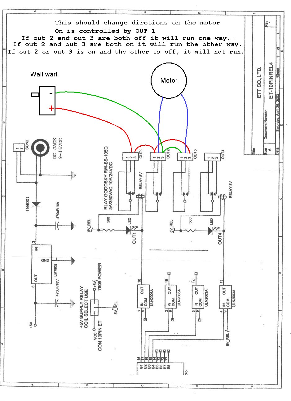

it is a pretty simple set up. Only, it does not seem to respond as I assume it should work. Here is the diagram that came along with it:

On the outputs, #2 is common and normally connected to #1. When energized, #2 is connected to #3.
It looks like a logic 1 (+5 v) on P0 input terminal will turn on out 1. P1 to out2, P2 to out3, P3 to out4

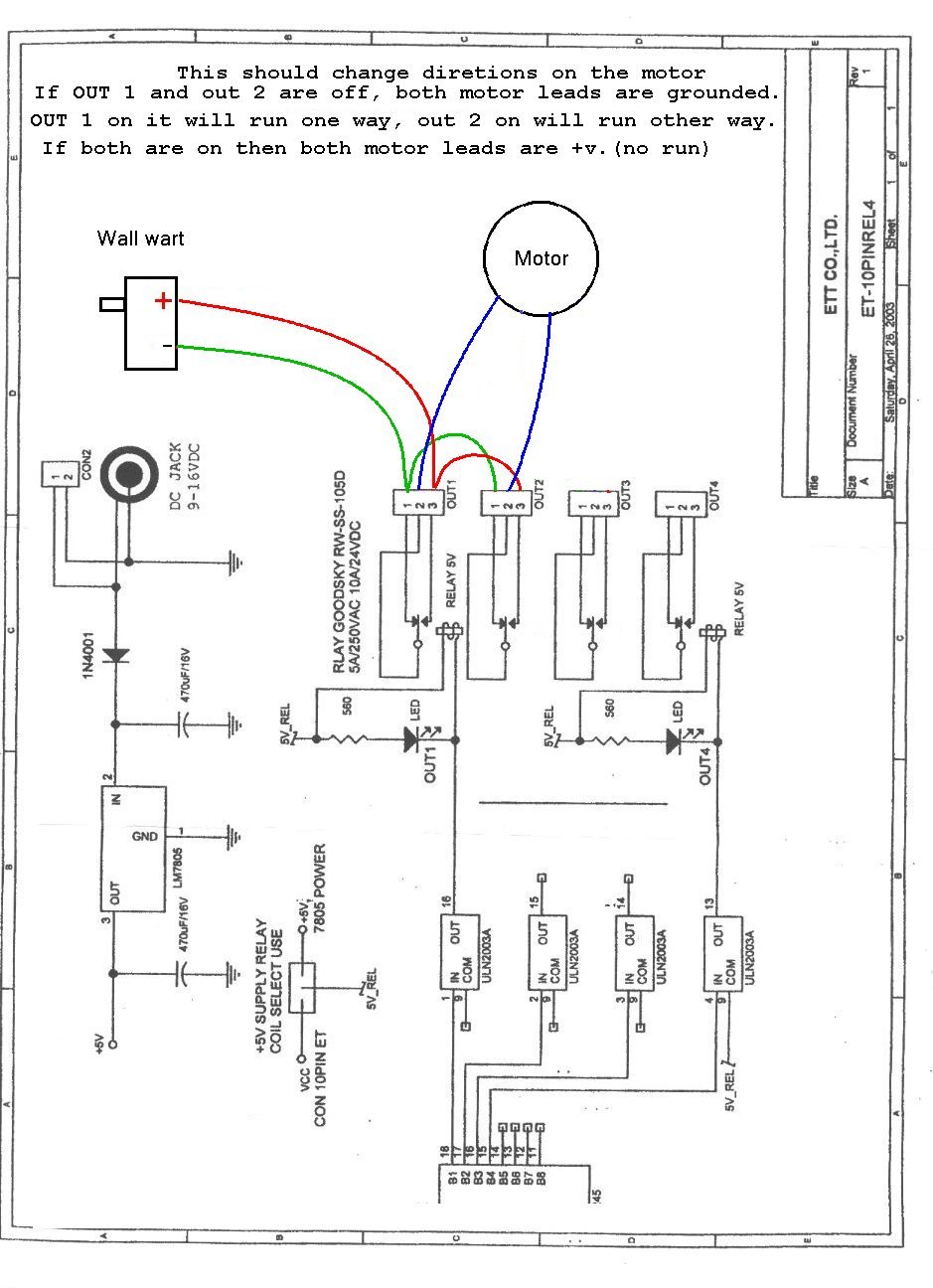

I'm curious: is there a simple addition to this that will allow me to reverse the direction of the motor?
Try this. Motor won't run if both are not on or off.

You may find this one better.
