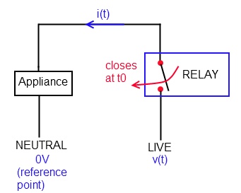

I think i just dont understand the definition of switching power.
Is it the power dissipated on the load at the moment when the contacts make or break connenction?

No, switching power is the TESTED power the device is rated to switch. In the real world under high power loads this often simply speaking can't be done, the arc and current to follow will bypass the physical linkages themselves.

What power is the relay switching?
In the following example, the relay switches the appliance at t0.
What is the switching power in this case?

Alphacat that's pretty self explanatory, if the relay ACTUALLY closes at T0 then the switching power is zero, thing is relays don't switch instantly and there's contact bounce, so realizing this in practice isn't always easy.
I'm not sure i got you.
If the relay closes at t0, and say keeps bouncing for 10ms (this is the average bouncing time i measured in my relay), what would be the switching power in this case?
It would be very helpful if you could refer to terms like v(t0), i(t0), Rapplinace as appeared in the shceme.
movs-jpg.35732
Thank you again.
Depends on the voltage and frequency of the live wire alpha, and what the effective contact resistance was when the contacts were bouncing. 10ms is almost a complete cycle of 60hz AC so it's not going to be good if the resistance of the load itself is small.

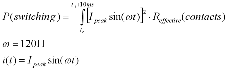

Oh, i think i got your point!
Is this the switching power?
relay-jpg.35797
Is Reff(contacts) equal:
[Duty_cycle * 10ms] * R(contacts)
Where the duty cycle is the fraction of switching time which the contacts are connected to each other.
If its true, then why do they mention P(switching) in VA, while the R(contacts) is pure ohmic?

I have no idea how they actually calculate switching power, there's no standard that I know of. Suffice to say whatever is written on the datasheet is what that company thinks that device is capable of switching safely and reliably. If you violate the rated switching power of the relay you'll end up with carbon scoring and/or welded contacts. Also the power factor is mentioned if the relay is driving an inductive motor load, as a low power factor will force you to derate the relays switching current. As you can tell by the datasheet the switching current of the relay is abysmally small compared to the maximum the contacts/conductors are rated for. This is typical of a relay and why they tend not to be used in high power applications anymore or as frequently as they used to.
