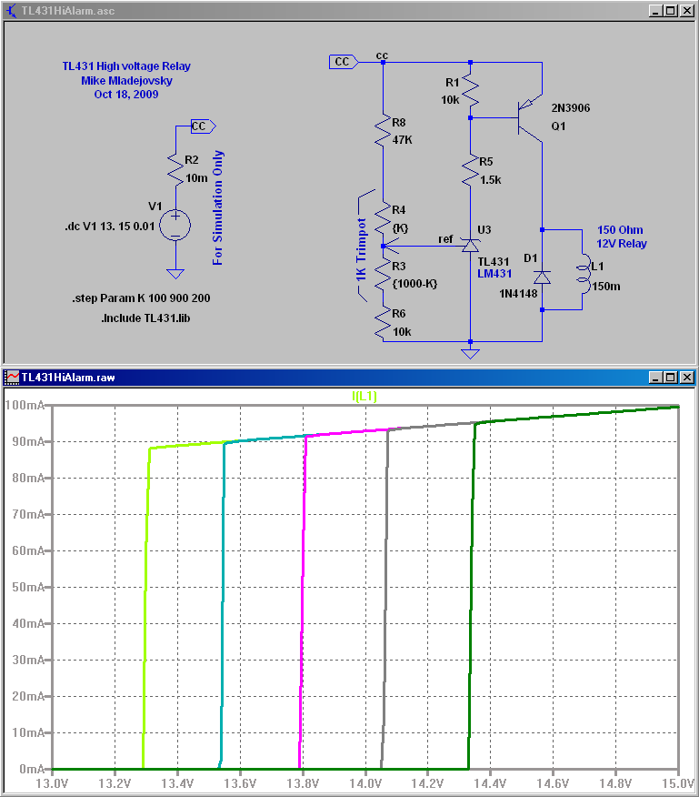

Here is a circuit which is close to what you need. I did this for a different application and needed an adjustable trip point near 13V. It wouldn't take much to adapt it to what you need...
It is also possible to run the relay so it pulls in at say 15 to 18V and then drops out when the voltage reaches 24.0V.

Well, to get the current lower you will have to get rid of the relay. The PNP transistor shown is off while the voltage is low, and it turns on when the voltage reaches the set point. How do you propose to shut off the audio?

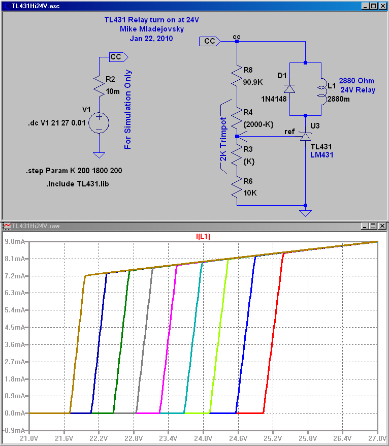

Look at this: I modified the original circuit for your relay and 24V. Adjustable by trimpot from ~22V to ~25V.
Thanks for that. Thats great.
One thing I'm thinking however, is that maybe relying on a circuit to only come on at 24V is a little bit too picky to work reliably. (eg. I'm not sure if it works if it comes on 23.5V, 23.8V, 23.9V)

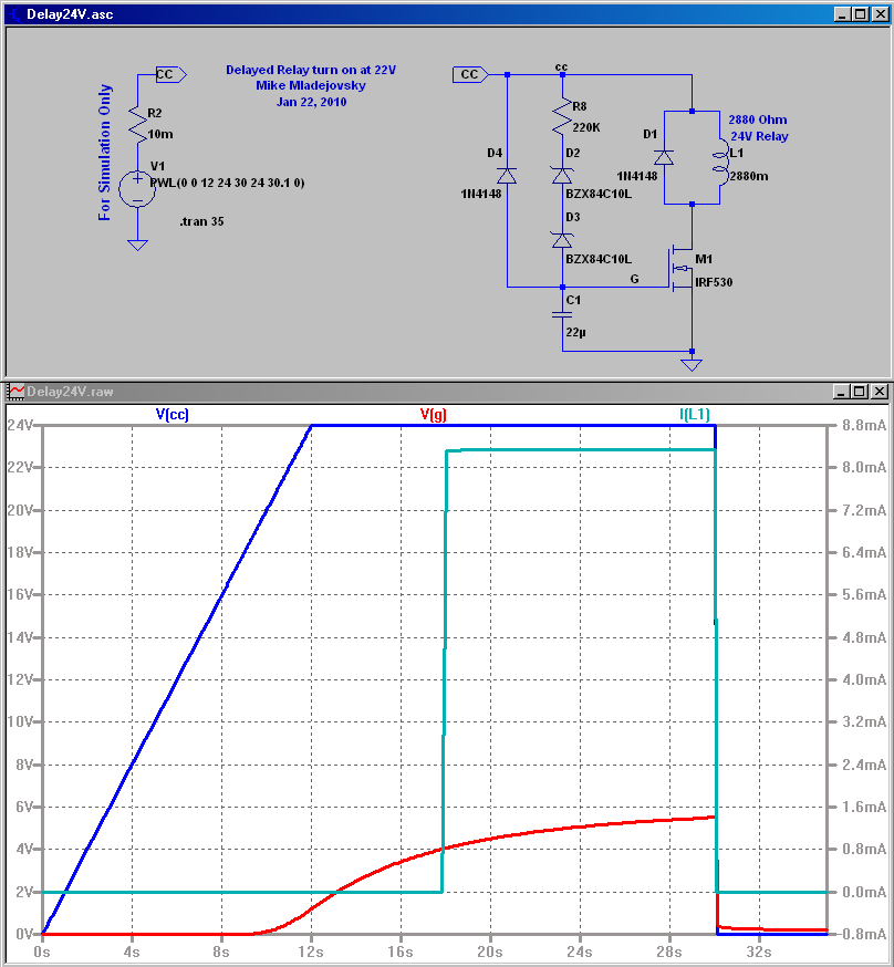

Maybe I should be doing a circuit that only starts at say 22V, but then has a 2 sec delay to turn on (when 24V has been reached.)
Or failing that, maybe just a 20sec delay circuit would work. (Long enough to clear the amount it takes to go 0V - 24V + some clearance time)

The delay is not long enough because of the low value resistors. This circuit using a NFET provides about 5sec after the input voltage reaches ~20V. I didn't have a 20V Zener model, so I just put two 10V Zener's in series. D4 is to discharge the timing network for the next cycle. The NFET is nothing special... Cost of a Zener is higher nowadays than the LM431...
Ah that looks like a winner. Graphs look exactly like what I need. Low current drawn. I'm pretty sure I can squeeze it in. Small cap (probably 6.3V rating too would do?).
Great. Thanks for the help.
Do you think I can use a TO92 part instead of TO220? Maybe a 2N5457?
The 2N5457 is a depletion-mode JFet. The circuit I posted needs an enhancement-mode N-channel MOSFET. There are lots of those available in tiny packages. Just make sure it has a VDS rating > 35V. Look at Digikey. They have a selection tool which should help you find one...
Actually thinking about it, the 2N7000 has a lower threshold voltage so will turn on a little quicker than the IRF530,
so maybe I'll increase the cap a little to 47uF or higher.
