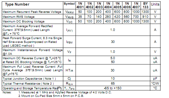

Its absolutely essential you fit a supression diode [1N4001] across the relay coil to protect the PIC.
exactly 1N4001? can't 1N4007 do the job? i have 1N4007 in hand.
Yes OK, the last number is the maximum working voltage, '1' means 50V
and '7' is 1000V.

your answer means i can't use 1N4007?
YES, why ask?
No. my answer does not mean you cannot use, it means you can.:)
It over rated for the job but it will work just the same as the 1N4001.
