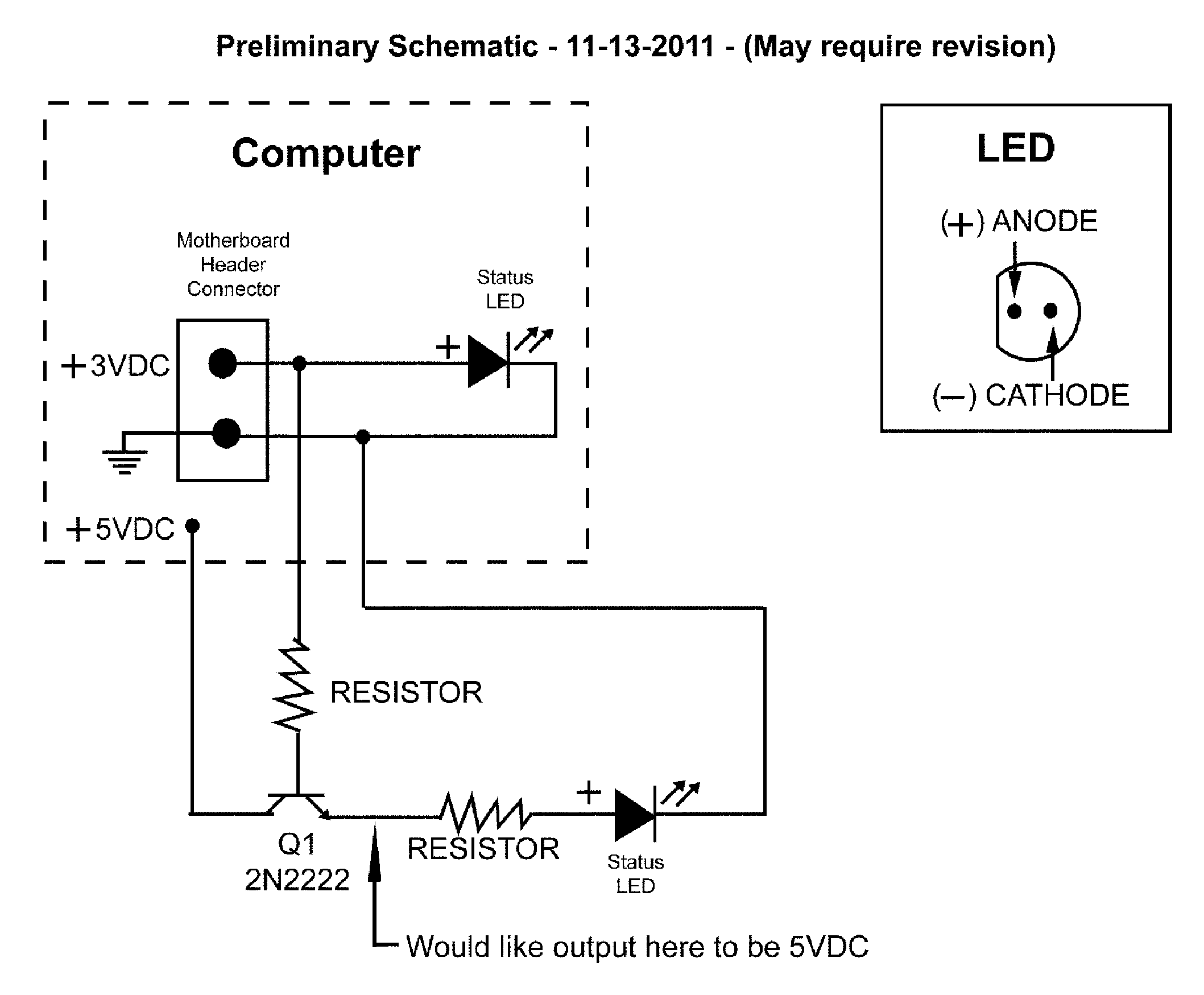

Going by your sample, I have reconfigured the circuit to look like the attached drawing.
Please review and comment.

The earlier drawing I posted had an error with the identification of the LED terminals.
Here is a revised drawing.
Near as I can tell (need a new volt meter) my motherboard has a 3VDC output for it's status LED.
You need to get it like mine. The LED and LED resistor are on the transistor collector. You have them on the emitter.
Ron
If I do that, It seems the point before the LED resistor will always be high.
I was trying to use the transistor as a switch.
If you set it up as I drew it the transistor serves as a switch. The transistor completes a path to ground when it is on. Yes, the LED and Resistor will always be high if we want to look at it that way. The idea is using an NPN switching transistor (2N2222 or 2N3904 or any basic NPN switching transistor) is when we turn on the transistor we complete the path to ground for the LED and its series resistor.

I can see that the circuit you drew will work, but prehaps will not work in the way I desire.
I think of a switch as being either on or off. This is what I would like. Either a 5VDC output or 0VDC.
My lack of knowledge may cause me to ask the question in the wrong way.
An isolated output, in addition, may help protect the motherboard.
Please comment. thanks.
OK, in what I drew if we removed the LED and let's say made the series LED resistor 10K Ohms. If we looked at the collector of the transistor when the base had a signal from motherboard the collector would be about 0 volts (the transistor is switched on). If the motherboard signal is low the same junction would be a 5 volt logic level. So as drawn you could have 5 volts or 0 volts.

Figure 1 - For clarity, I have redrawn your original circuit proposal. It should now be mostly correct.
Figure 2 - If I understand you correctly, Figure 2 should represent what you tried to tell me verbally. TEST POINT A will be 0 volts when the computer status LED is on and 5 volts when it off. However, as I see it, the external LED will be off when the computer LED is on. Could we reverse this?
As an afterthought, I think TEST POINT A Should be between the computer 5 volt supply and resistor R3. Please comment.
