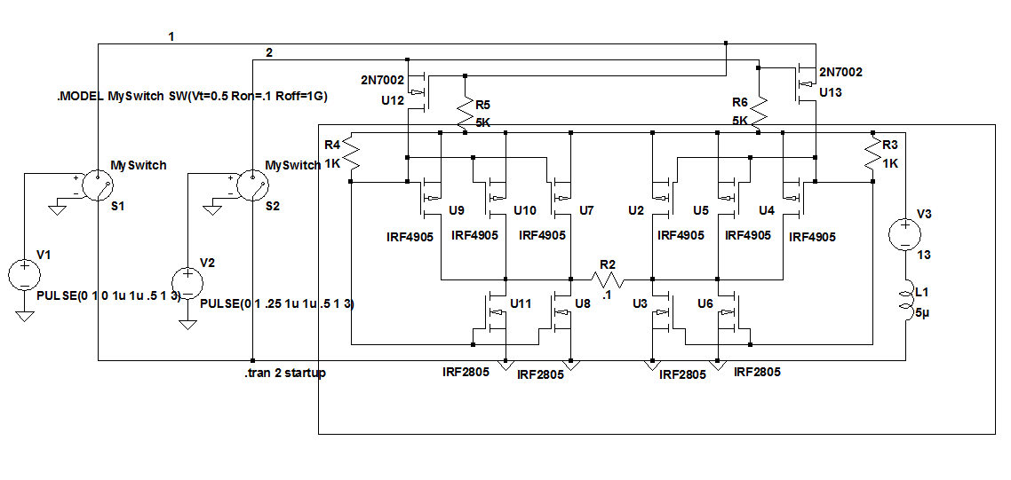

Paralleled PFETs, My understanding is that the PFET can't handle what the NFET can, so I paralleled them. Specs on the IRF4905 is -74 A and the specs on the IRF2805 is 175A(silicone) 75 A package limited. I used one resistor per side to turn on both NFETs and turn off both (all 4) PFETs and the ground signal to one side or the other turns on the PFET while turning off the NFET. Having both NFETs on creates dynamic braking from the motor and again, I use the NFETs because they're supposed to be more robust.

It really depends upon the current rating and ON resistance of the FETs.. If you buy a P-MOSFET with similar ratings to an N-MOSFET then you don't need to parallel the P-MOSFETs.
I am worried about the stall current of the winch, hopefully it will be less the capabilities of the FETs and I haven't found a PFET with a higher rating the -74 amps

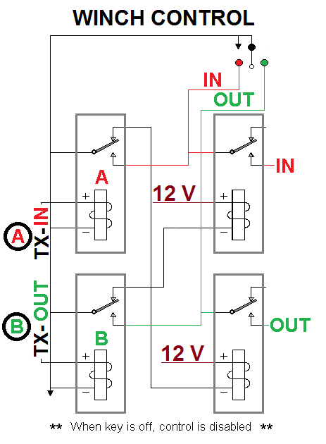

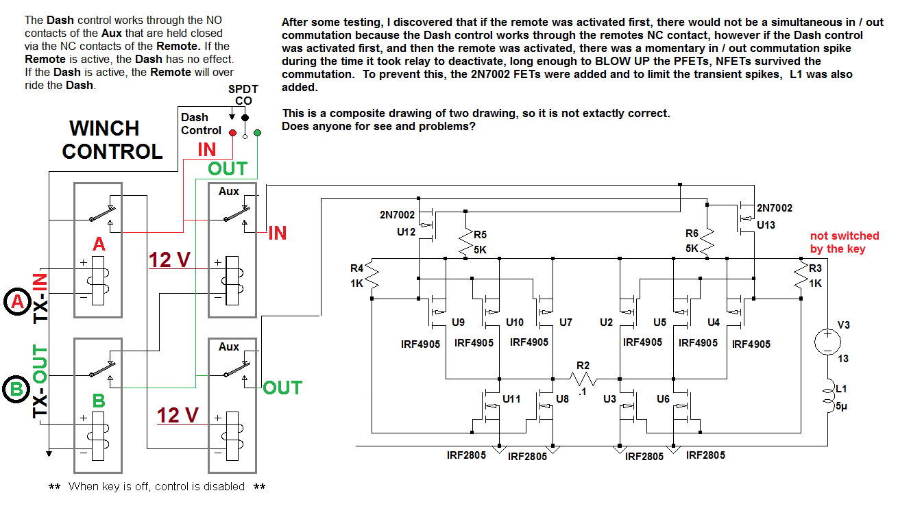

Here is what I plan to use, after showing an earlier version to my son that blew up 3 PFETs. I would appreciate if others would examine my work and see if they can find any potential problems.
Thanks so much,
Kinarfi

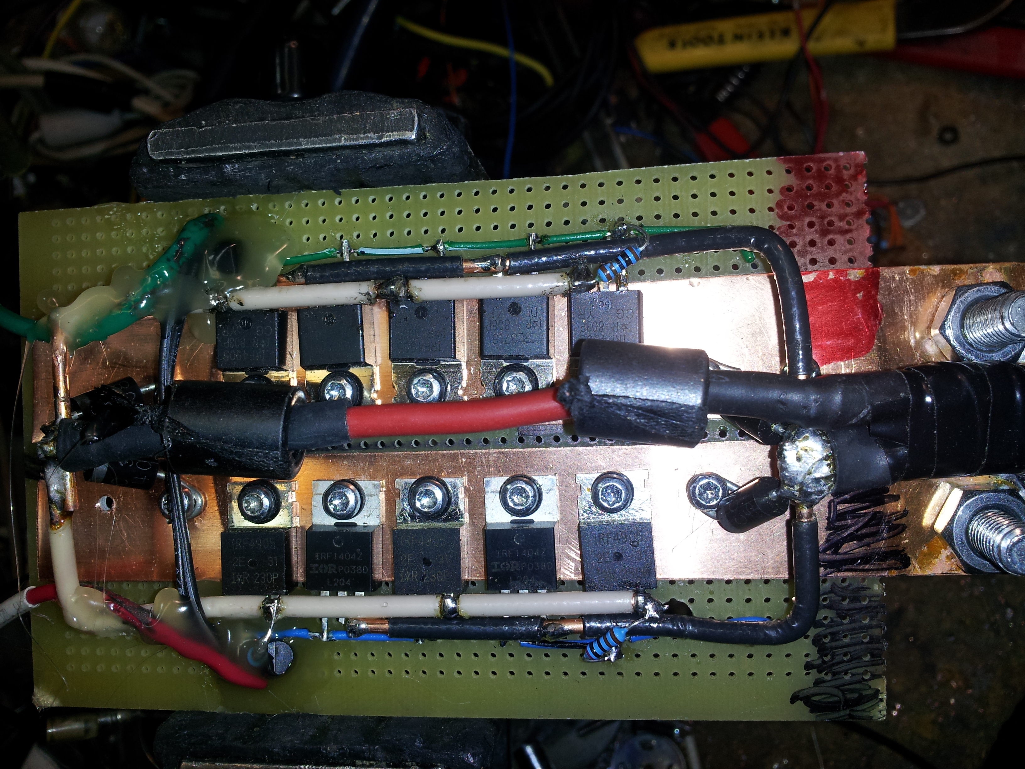

Here's the "final" product prior to encasing and installation, works well, I have tested it several times by applying both in and out signals and had no failures.
Edited the opening post, this experiment was a total bust!!!!
