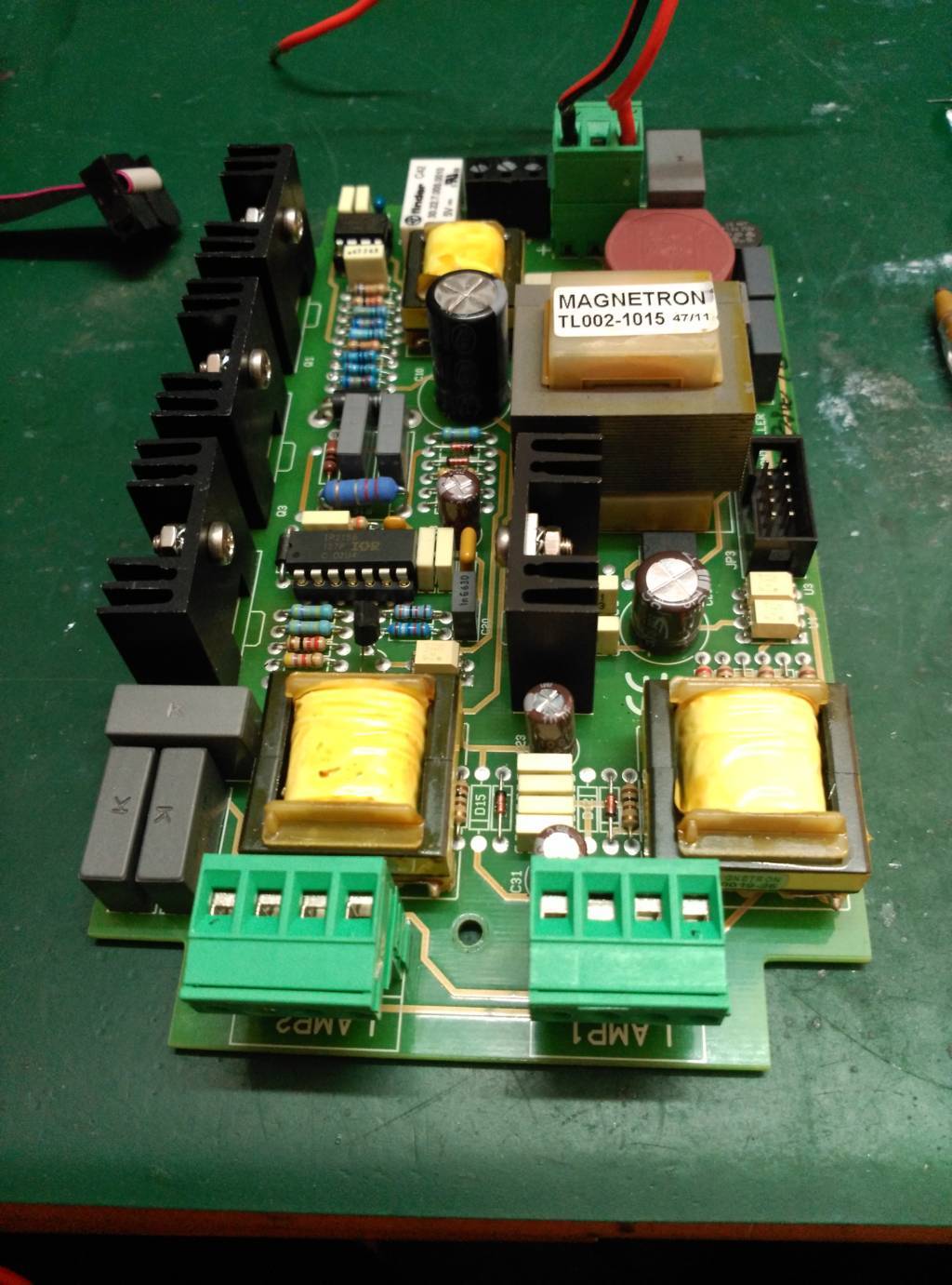

It didn´t work properly, it says LAMP1 OFF and LAMP2 OFF. They give me back the unit now with original lamps but when I was checking it again I don´t know what happened, I had very low value between gate and source, I removed the mosfet and when I measured it was OK, but when I measured at IR2156 pin 13 (low side) I didn´t get the proper signal as in pin 11 (High side). I decided to open gate resistors to see if something was overloading the driver IR2156 and it seems after that both mosfet IRF840 were damaged. Now, without the mosfets, when I measure at pin 11 I have a proper PWM signal but when I measure at pin 13 I don´t have a good one, I measure against ground. I think I should get PWM signal at both but opposite phase, isn´t it?
I ask this because I still have IRF840 to replace them but I should order the driver in case the low side is damaged...

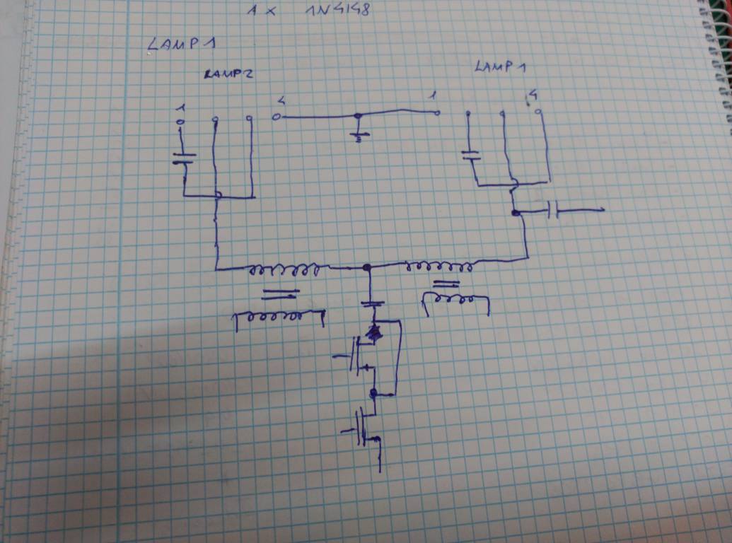

I saw that image at datasheet too but this is not what I get at LO pin.
Yes I have a scope, I will post a picture of the type of signal I get. Anyway tomorrow I´ll order the driver and I´ll test with the original bulb. I´ve seen the original bulb also has 4 pin but all of them on one side.
I'd agree with that too, you could have a pair of fets in parallel but unlikely with that driver, push pull is the most likely.
Most common for push pull is that there are 2 n channel fets, the source on both being grounded, however double check the layout, one might be high side and the other low.
Put a bulb in series with the supply when testing, you'll need something of reasonable wattage not to loose to many volts.
Yes, they are in push pull connection, drain from one to source from the other.
There are 2 ways (I know of) for push pull, one common + to the centre tap of the primary and a fet switching each end of the primary to ground, or as I suspect in your case 2 primaries, one with an end grounded and a fet to the supply, the other with an end at + supply and a fet to ground.

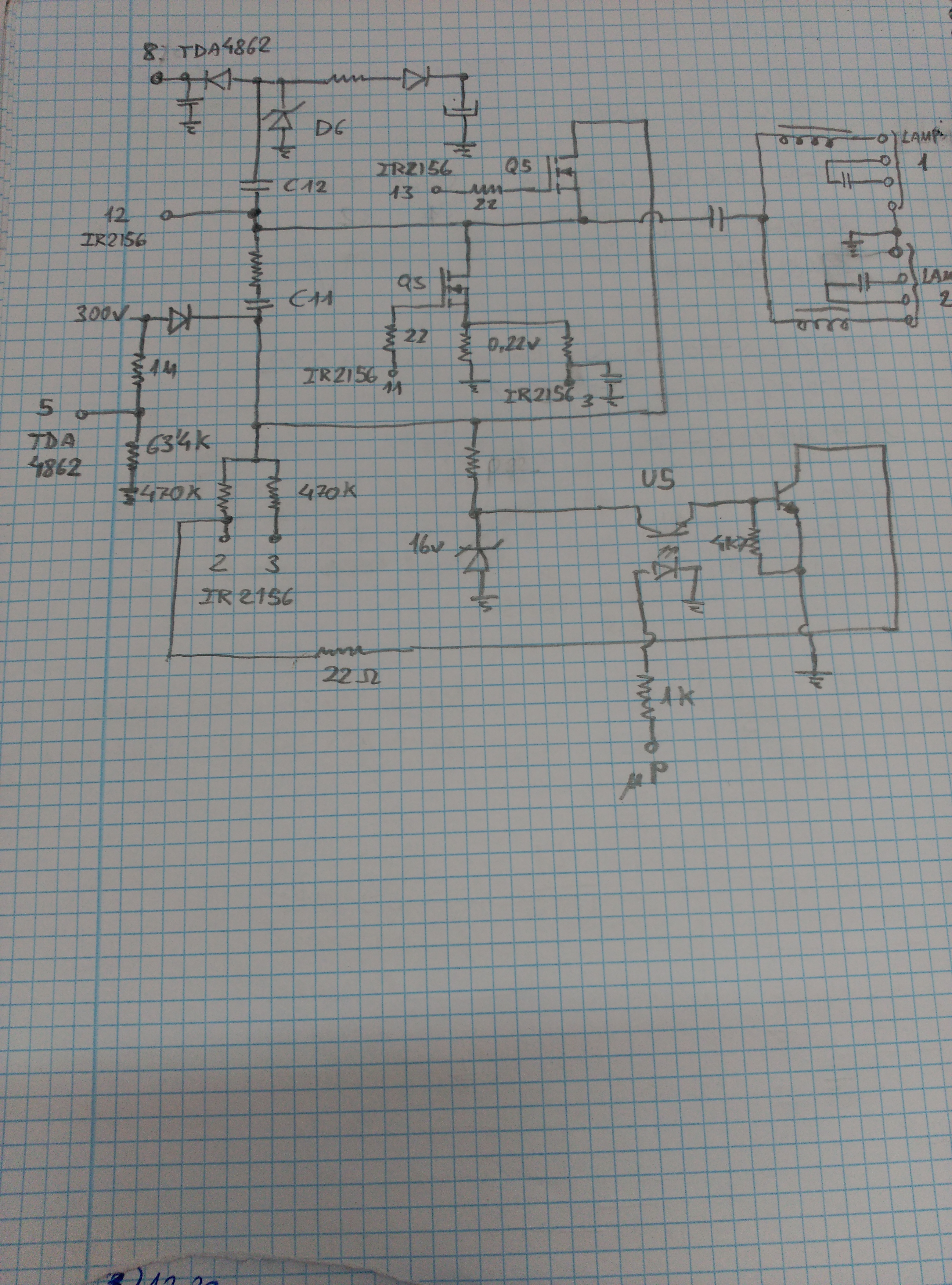

Hi guys,
I still have problems with this unit. After replacing mosfets and driver I found a 330 ohm resistor at 500 ohm value and a 18V Zener damaged. The problem I have is that I don´t get voltage at TDA4862 for PFC. I only see one way to get voltage at its pin 8 (see at drawing), no other power source as for example in datasheet example a startup resistor directly from rectifier or from secondary coil used in PFC.
I gave direct DC power at D6 zener diode without 220Vac input just to see what I got at TDA4862 and at IR2156. IR2156 pin 11 and pin 13 shows a perfect PWM signal. However TDA4862 pin 7 shows nothing and when I cross threshold voltage startup it shows DC voltage, not PWM... I tried with another new one and is doing the same so maybe it needs high voltage input.
When I give 220Vac input I see how U5 blocks the unit with no voltage at IR2156 and "Press Start" message on screen, then I press start unit release but I only get 10,6V at pin 2 and 3 at IR2156 (not enough to start it up as I saw it needs 12,2V to start up) and of course 0V at pin 8 of TDA4862.
I attach a schematic I did:
