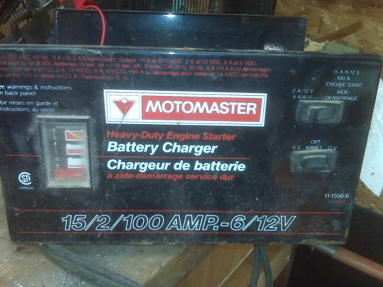

Hey everyone,
Quite excited to be on the site, and hope to gain ++ information from everyone here.
Yesterday I started tinkering on an old 12v battery charger i picked up in a pile of stuff from an auction. As soon as I opened it up, I noticed corroded connections and melted wires. I started replacing them with copper (rather than the aluminum it had) and upped it to 18g. my next piece as I was looking at it, has a steel plate with connections located. These are where the wires connect to. The bottom pair are intact with a small black ?resistor? and the top two are not there with some black arc noted on the plate. I pulled one of the little items out, but as much as I google it, I can't find out what it is, and where to get some. I stuck an ohm meter to it, but doesn't show any resistance.... Any tips? I'll post some more photos of the unit when I get a second. I'll try to get a pic of this little thing asap.
Thanks for your help in advance.

Here's the unit

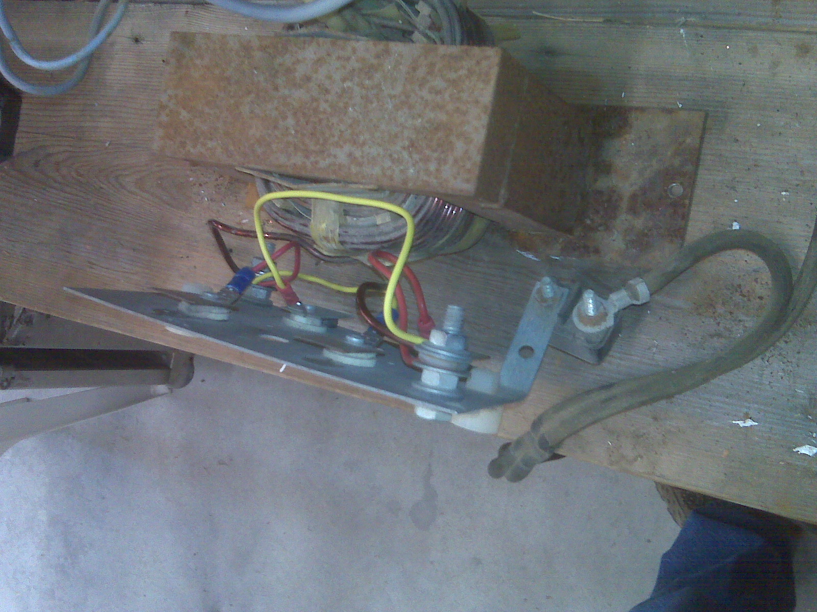

Here's the setup inside. Note the new wiring placed in there.

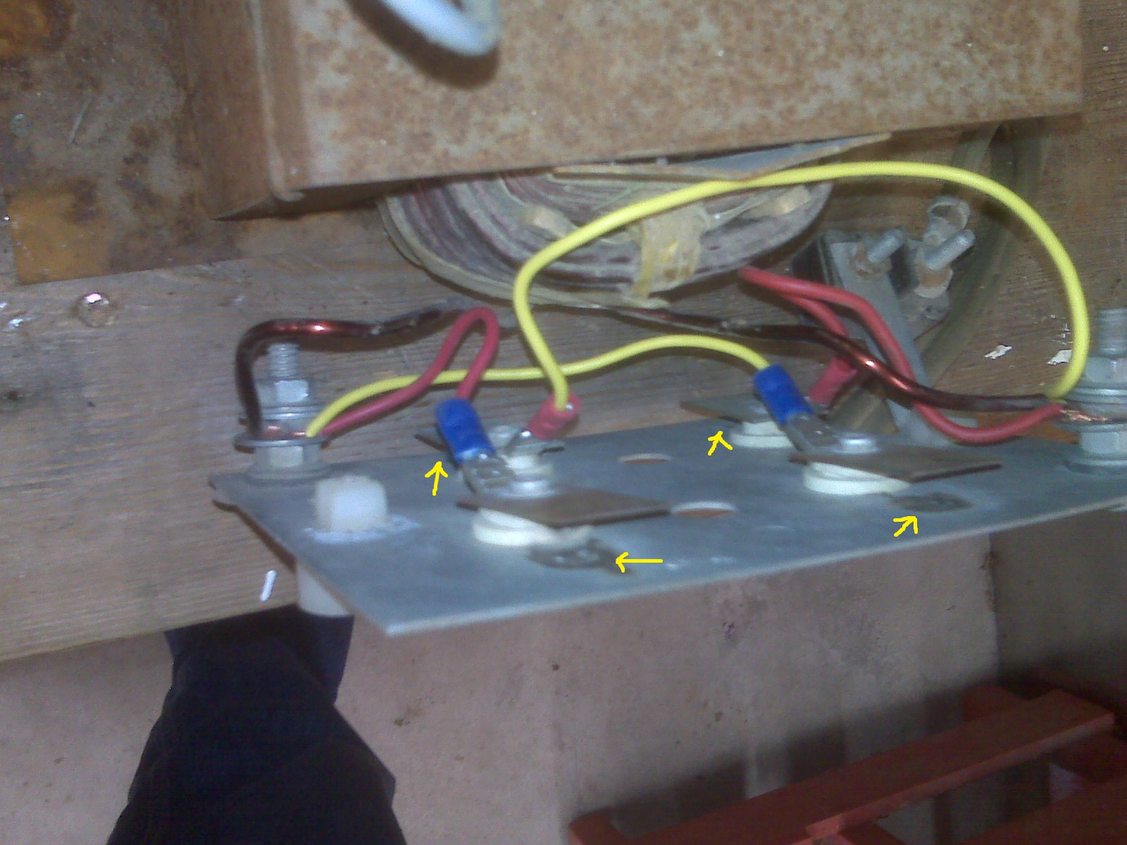

Where you can see the clips attached to the new wiring, that is where this little black piece goes - I'll draw an arrow on it.

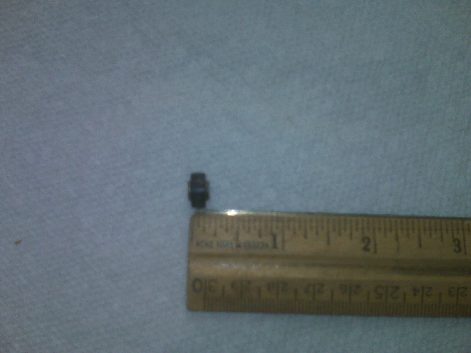

Here's some photos of the little black piece. There is writing on the side of it: It has the Motorola symbol - then 1504T1E27
Hope this helps. - I apologize it's blurry - old school Blackberry....

There's four arrows there, so four black pieces? They're diodes for a full bridge rectifier for the output of the main transformer maybe, not a capacitor in site though, this isn't exactly state of the art in charger design =)
Thanks for the info. How do I determine what size of diode they are? And yes, 4 of them. 2 still there, although the one I popped out has a crack down the side, so I would probably get 4 new ones...if I can figure it out. Thanks again
Well they're rectifier diodes so they need to be rated for the full current they're intended to draw, which in this case is 15amps for charging, and it has to have a 100amp peak power handling ability, probably with a rated voltage around 20 volts. From what little I can recall they're called disc diodes, and the thing on the outside is probably not part of the diode package but an insulator. You'll want to replace all four no question, the form factor of the replacement diodes is kind of important because those types of diodes are very closely physically linked to the chassis so they basically use the housing as a heat sink. If you use a radial diode or TO220 type package heat sinking becomes important.

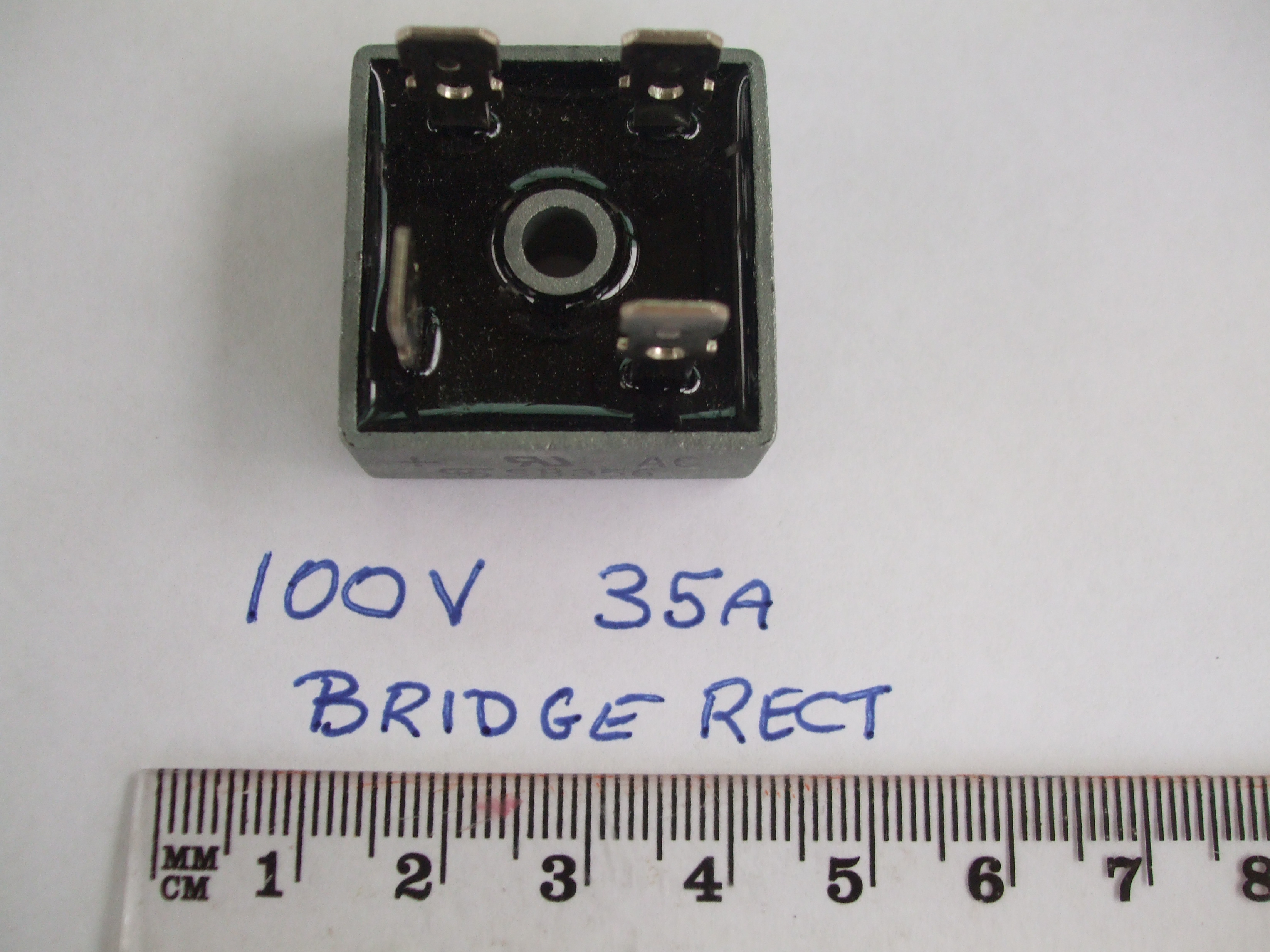

Probably cheaper to use a $5 100V 35A bridge rectifier on a heat sink. These are what ive used as replacement in small battery chargers.

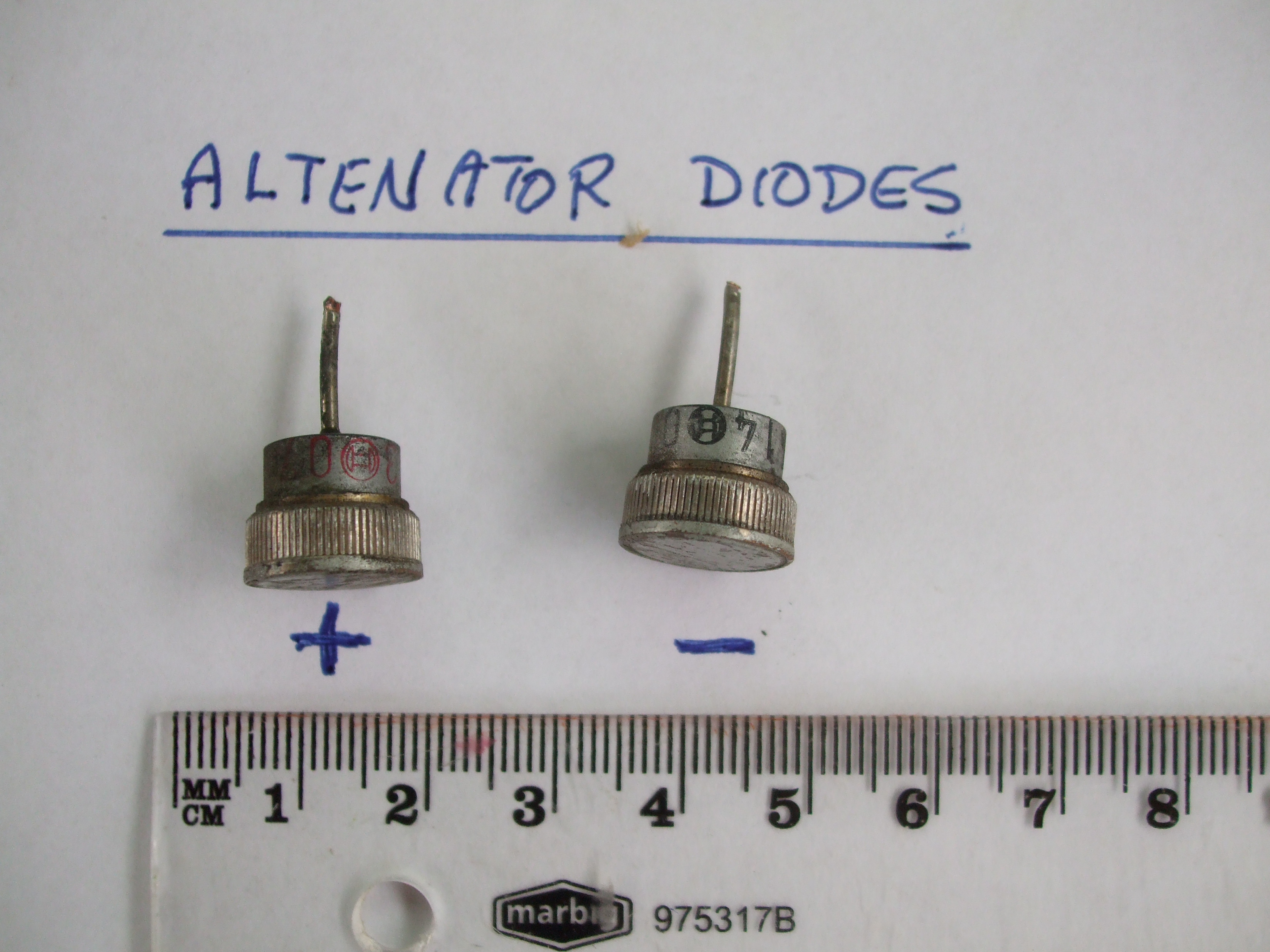

A free source is old car altenators with press fit diodes, theres 6 of them. 3 Pos & 3Neg polarity. They will do the job easily.

I'm going to look for the 100v 35A bridge rectifier today when I'm in the city. Hopefully something comes up. I assume that I can basically override that whole steel plate and just connect the 4 wires to this?

I suspect you haven't considered that the original parts 'may' be important.
A battery charger basically consists of three items:
1) A transformer.
2) A rectifier.
3) A current limiter.
It's the third which is 'vague' - it could be an actual physical resistor, it could be a specially would and designed transformer, it could be the special rectifier (metal plate), it could be the wiring between them (one reason for thin aluminium wiring - which only seems to be used in the USA?). Or it could be a combination of all of them.
Replacing the wiring with thicker copper, and the rectifier with a modern silicon one, 'could' remove any current limiting features.
