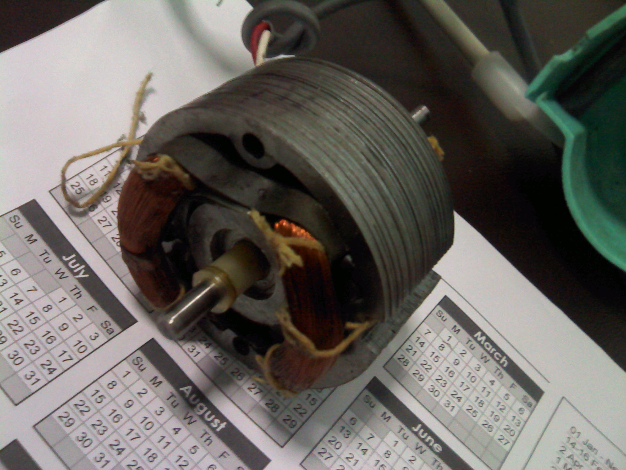

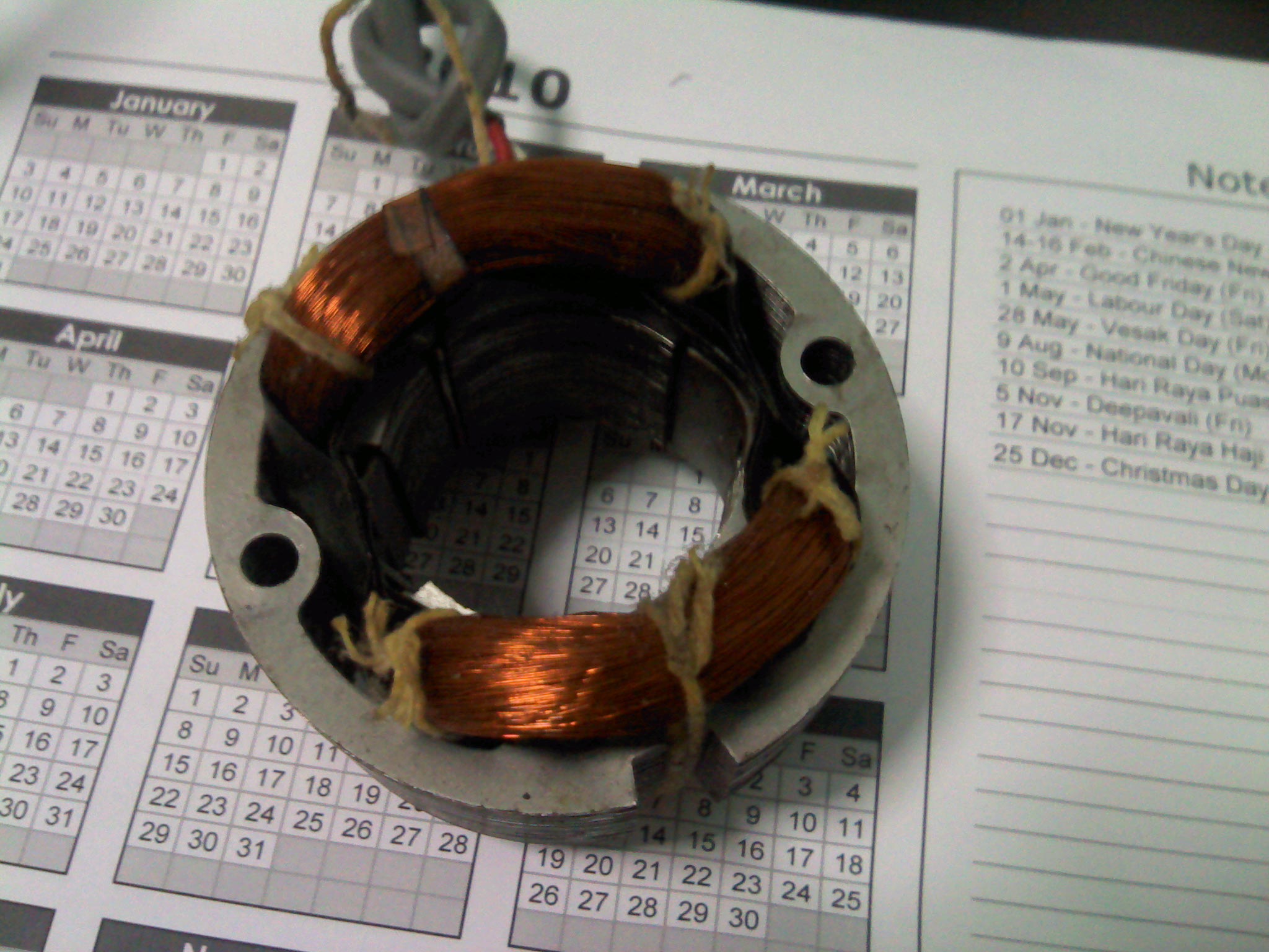

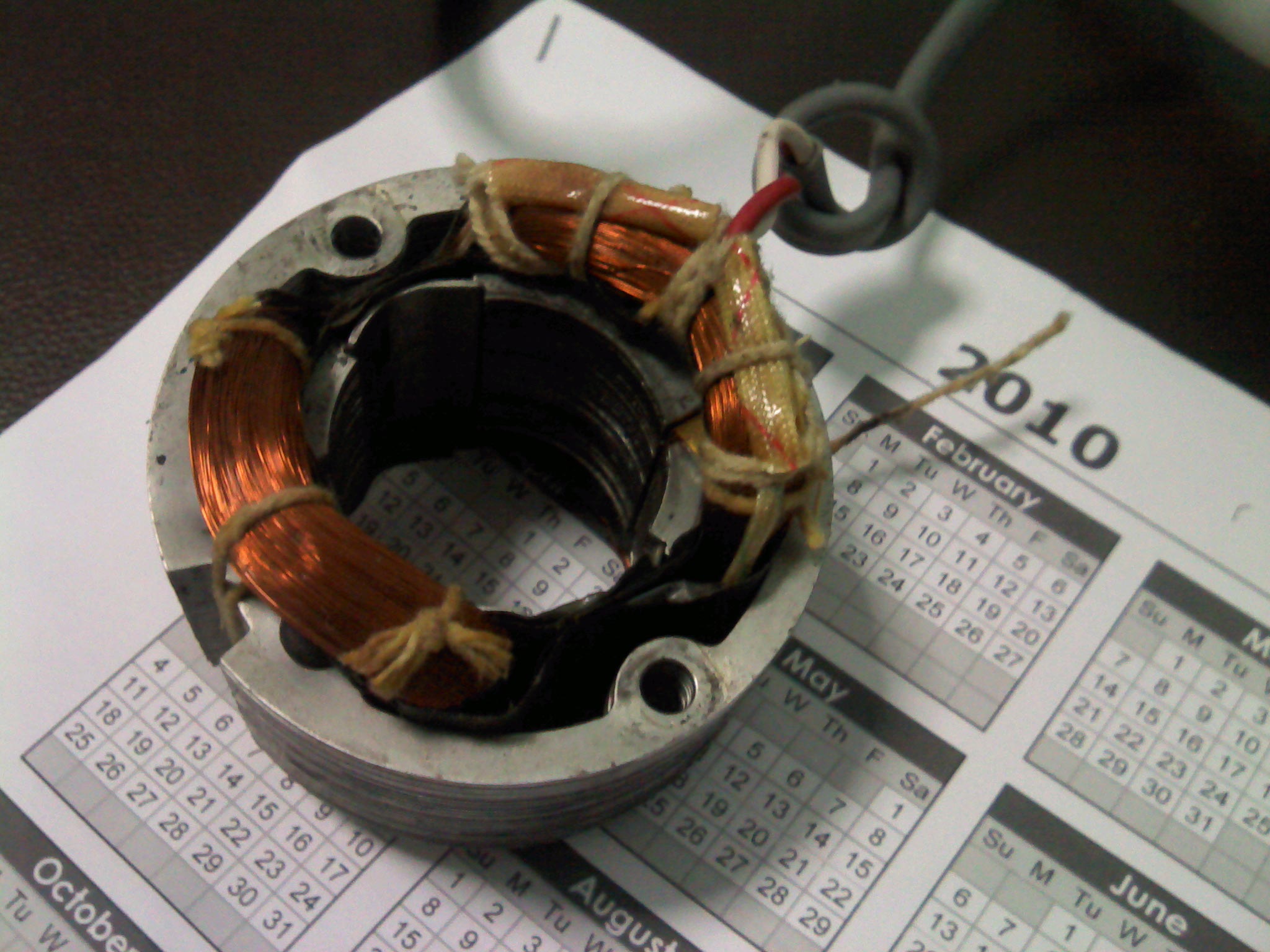

Hi
My table fan dropped from the table to the floor last night (because the fan was at full speed and it moved by itself bit by bit during operation). Now the fan won't spin anymore. Upon taking it apart I observed the following:
1. No aparent physical or electrical damage. The winding seems still intact, no distortion of mechanical parts which would have been a result of the drop. In fact, as I know, fans seldom die from drop.
2, The armature, seems to be working. It stil generates a strong magnetic field when turned on without the axle.
3. Without the axle, the motor generates noises as if it was operating normally.
4. When the axle is put in, the noise generated by the motor reduced, and the axle could not rotate, even if attempted manually. In fact, it's very easy to rotate the axle manually when turned off, but once turned on, it's difficult, if not impossible. If the screws are tight, the whole mechanism just sticks together, perhaps because of the magnetic field and moving the axle would move the whole thing. If the screws are not tight, moving the axle would spin it a bit, but does not start the motor as expected
Any ideas what's wrong? Thanks in advance.
I'm actually not sure whether a table fan(ac) has a starter capacitor. It seldom fails and I don't think that's the case here..re-check the winding.
I attached some images below.

From my understanding, the inductors will generate repelling magnetic fields so the motor shaft will move. There are 2 inductors, the left one will generate a field on the left part of the armature and the right one on the right part. The 2 magnetic fields repel each other and the shaft will move. So the windings in one of them is open, the magnetic field will not be present and the shaft won't move but is instead atracted by the other magnetic field. If I remove the shaft and use a screw driver to test the field, it seems that magnetic field is present on both sides of the armature as the screw driver can be attracted to either the left or the right. Can I conclude that the inductor are still intact?
@ Mickster: by 'spindle', do you mean the removable axle in my picture? If so, I have tested it carefully and there is no apparent damage. I can rotate it freely when power is not applied. Is it possible that it's somehow bent slightly but I could not see?
If it spins freely by hand it's not bent, at least not enough to affect the motor.

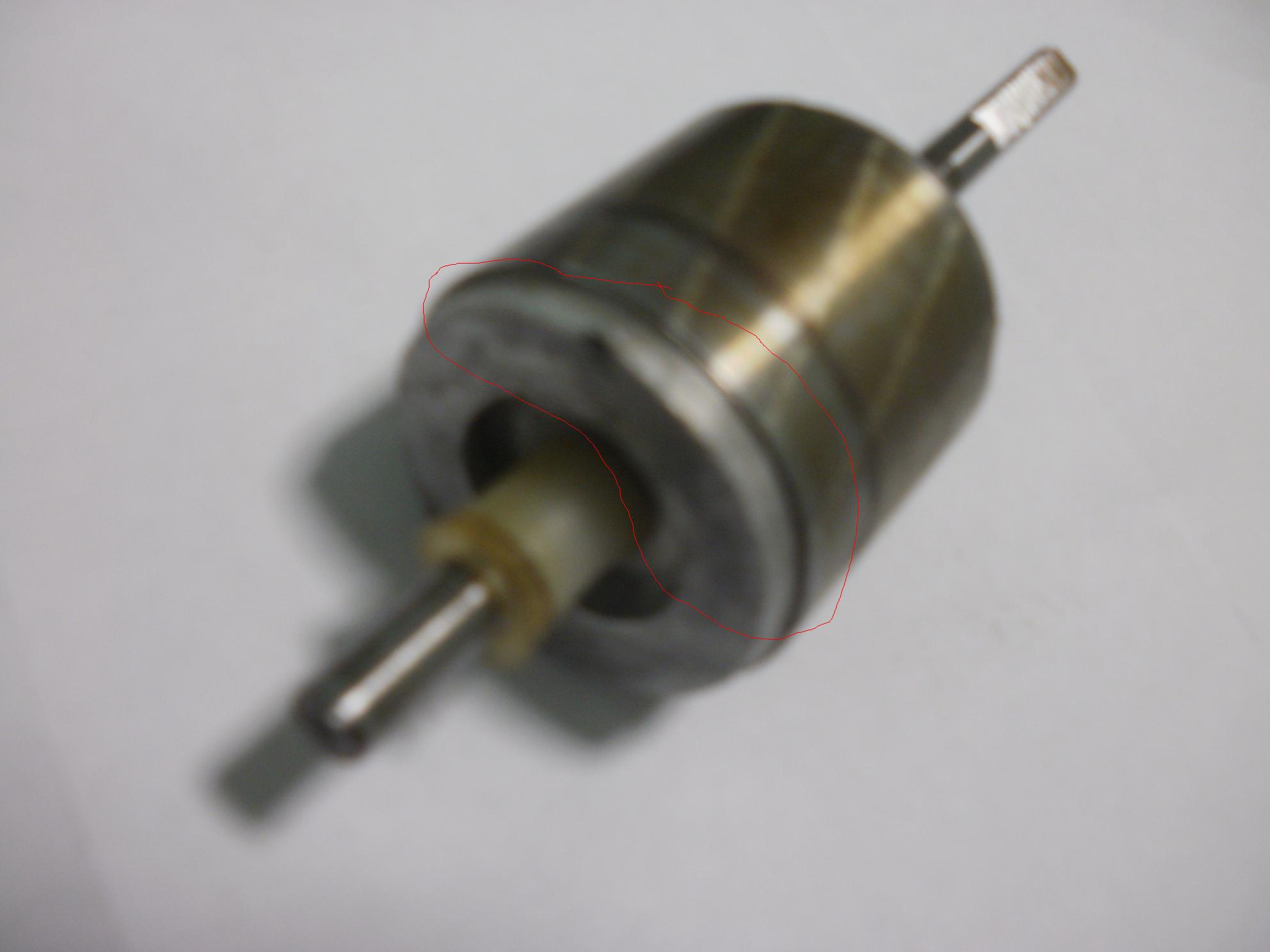

I have tested again carefully today and notice that the shaft can move freely within the shaft when no power is applied (with the screws tight). When power is applied, the shaft can actually spin by itself (albeit very slowly) in the bearings if placed at certain positions. When the shaft spins out of its "comfort zone" (which is less than 1 round) , it will stop spinning.
I attached 2 photos of the shaft for clarity. Do you think that the part highlighted in red is worn out and causing the problem? I assume when the fan was new, the highlighted part in the image was not worn out (e.g. flat), so the cylindrical structure of the shaft could spin inside the bearing with no issues. After it has been worn out, there is some imbalance, and the shaft could not spin.

Those photos are so out of focus it's hard to tell what you're talking about.
To get a better close range focus on a cell phone camera, put the lens from a "reading glasses" in front of the camera.
Nice suggestion Mneary. I took some photo's of birds through my regular digital camera at a decent distance simply putting the lens up to a pair of binoculars, placement was a little tricky, but the auto-focus on my camera is somehow based on the actual image itself so it self corrects if it's possible to focus at all.
I made some improvements. I aligned properly, cleaned and applied some oil to the fan shaft and the bearings and the fan is able to spin normally for a moment. However, after a while when the oil gets dried , the fan becomes noisier and slower and eventually stops.
