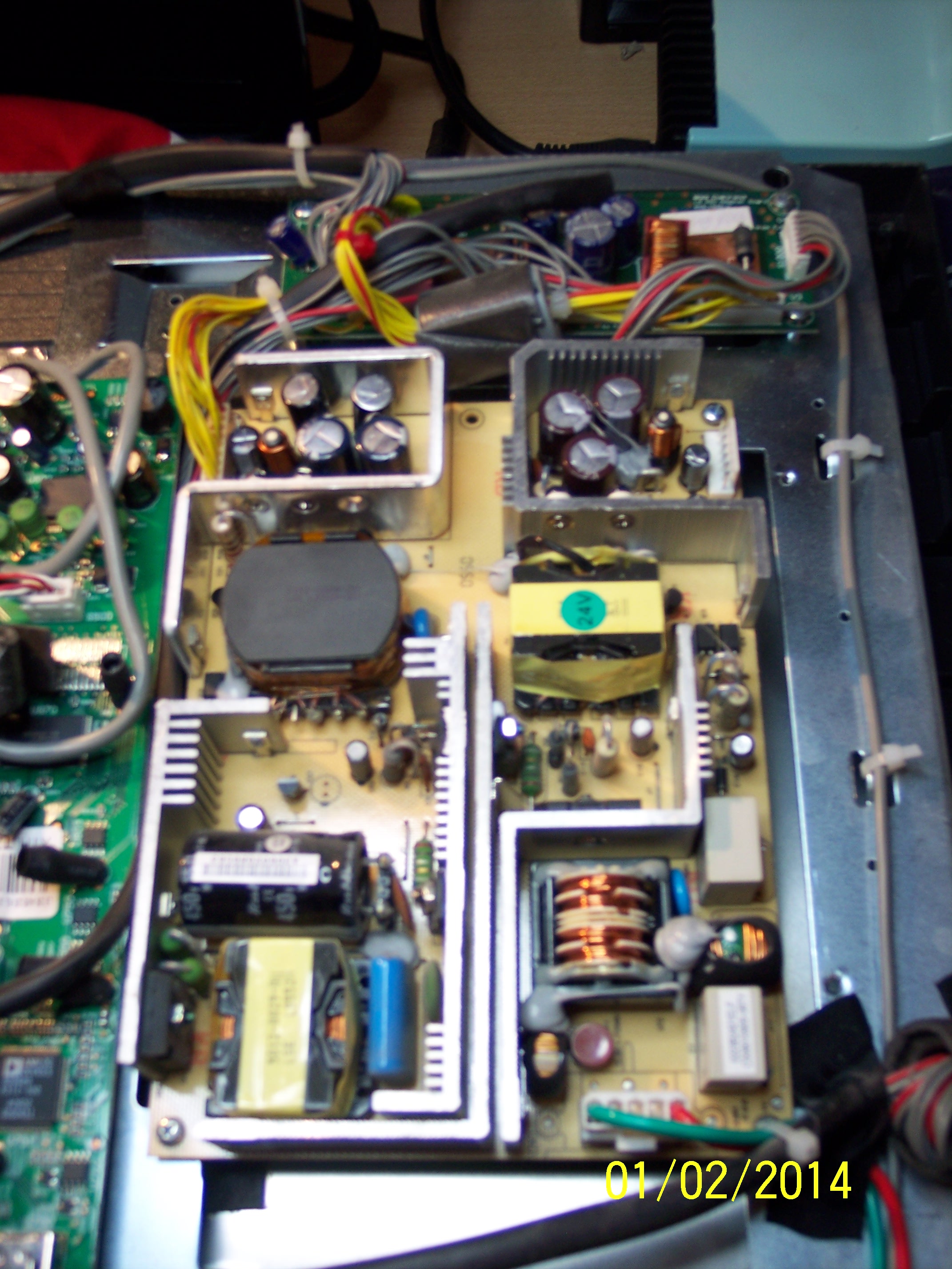

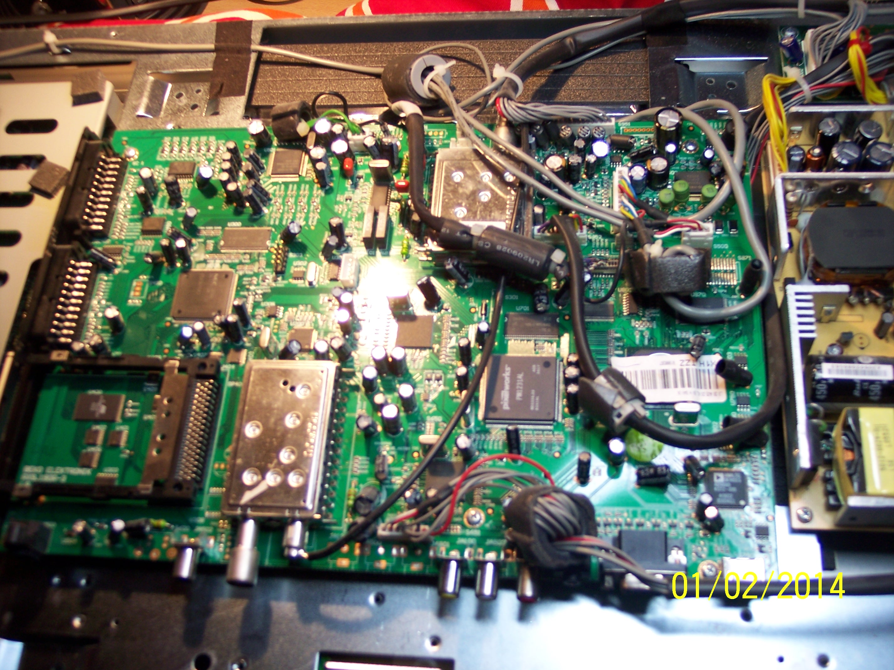

sheldons, please find attached pics and schematic of psu.
I still need 2 schematics :
1. Beko Electronik - L9 PSU adaptor board RX9, 194R-2
2. Beko Electonik - L9, main board RX9, 190R-3
Regards, Derek

There was no picture nor sound. Could not change channel, but the menu system worked both with the remote and controls on the tv.
Now I have the schematic for the smps I can test it - I suspect it is ok. But I really need the schematics for the other 2 boards to test them. This is important because it is my first (lcd) tv I have tried to fix and would like to learn from it.
Cannot believe schematics are proving so difficult to find !!!!!
Regards, Derek
Main board reciever probs make this a "good luck" repair issue.
Very brave of you to attempt the repair, even with the benefit of schematics.
But I applaud your determination :cool:.
A common fault on the cheap makes (like this one) is EEPROM corruption, 'sometimes' you can force it to reload the default values by shorting the data line to ground, or reload the EEPROM with data from a good one, or replace the EEPROM with a new pre-programmed one (obtained as a spare part).
I know Atmel had a run of bad EEPROM's a few years ago. Specifically 24C08.
We are still weeding sets out (CRT) where those specific EEPROM's have failed.
Symptom and most common fault is the set will not come out of standby even though all supply Voltages are correct.
But EEPROM's can do all other crazy things to a set too if they become corrupted.
