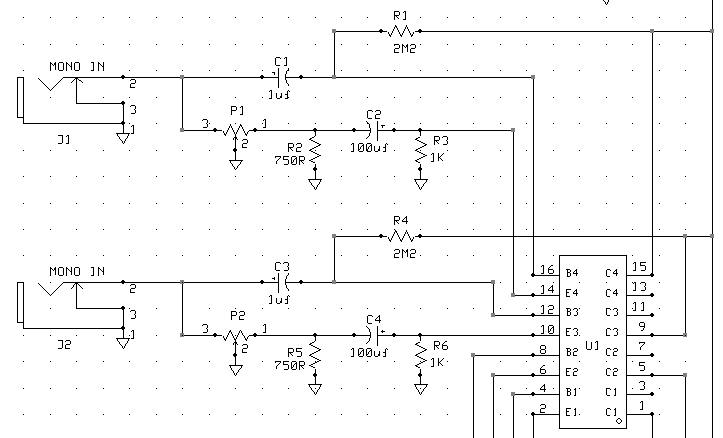

I would like to replace rotary pots with a digital pot to control volume.
I included the section of the schematic showing the potentiometer section.
I basically have (2) single pots and (1) dual-ganged pot.
I was looking at the maxim-ic device but there is a lot to choose from.
So what's the question, is there any guidelines to follow? Are these drop in or do you need supporting circuitry? I think you at least will need small push action switches to control the pot's steps. And then there is the question of using volitile or non-volitile.

I don't think there are any direct drop-in digital pots for analog pots.
The volume control in modern electronics often uses a digital rotary control to generate up or down pulses. These pulses go to a digital potentiometer (chip) to control the volume. You could also use push buttons to provide the up/down pulses.
Non-volatile digital pots are used for permanent one-time (or a few times) setting of the pot (such as would be used for calibration of a device). They also can be used to retain the volume setting when the power is removed.

To answer your questions specifically, there is no “drop in”. Supporting circuitry is needed. You need a push button switch if you do not use a microcontroller. You may choose a non-volatile device if you want the device to power up to the previous value.

Thanks for your help but when I contacted Maxim all they said is we don't have a 5K digipot and offered no other assistance except to look at some application notes.
I was hoping they would have said "you can use XYZ as an alternative if you change these resistors in your schematic" but that didn't happen. Maybe I was asking too much.
