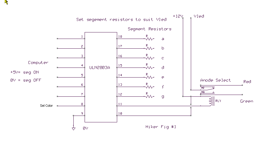

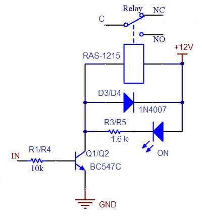

See the attached schematic for current circuit. The IN is +5v coming from computer and when present the relay is engergized. There are 8 of these which control a bi-color 7 segment LED display. The display has 2 common anodes, one for green and other for red and 7 cathodes. Seven of the cathode relays are used to switch on the display's segments by going to ground. The 8th relay is wired by N.C. leg to green anode and N.O. leg to red anode. The supply to common leg of anode relay is currently +5v but can be 5-12v.
I want to replace the mechanical relays with a solid state solution since I think it is overkill to control 5v circuit with relays. So I would like to replace with a SS device that would cause the LED cathodes to go to ground. I'm not planning to use any of the components in the current circuit but build everything new. Also the anode circuit needs needs to be a double throw type to control green and red colors. If I could control the segments by switching voltage like the relay coils are done now, I could just use the same circuit and substitute a SS device for the relay I think, but I need the inverse, ie, go to ground switching.

hi hiker,
Is it one LED segment per relay, like the earlier postings.?
IIRC its about 15 to 20mA/seg
Yes, one relay per segment, 7 relays for 7 cathodes and 1 relay for anodes, 8 relays total.
I simple and easy way would be to use a ULN2803A, I know its an over kill in the current capacity.
The ULN2803A has 8 darlington drivers, CMOS compatable inputs.
Use 7 of the drivers for the segments and the 8th to direct drive the anode select relay.
Price is about 67pGBP each.
get the datasheet from www.datasheetarchive.com

Can do, are there still 8 remote display stations.?
Yes, 8 all identical so I should be able to just make 8 of the same.
Have a look at this circuit.
You can use either +5V or +12V for the LED's, use a segment resistor to suit the LED current you require.
The relay is a 12V.
The input fromthe computer require no resistors, direct connect.
Hope you follow OK.:)
EDIT: note pin10 is the internal clamping diodes common connection.

OK, thanks, looks great.
So to made sure, the LED cathodes at points a-g will go to ground when +5v is present at pins 1-7 respectively, correct?

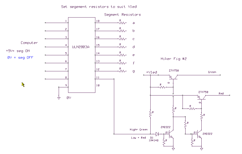

And to refine, can you think of a way to replace the Anode Select relay with something solid state?

YES, pins 1 thru 7 control the segments.
A seg will resistor will go to about 0.6V when the corresponding input is high.
So if you used a +5V supply for the LED's and they have a Vfwd of 2V then
for 15mA you need a Rs= [5-2.6]/0.15 = 150R
This is one option for the relay replacement.
Once you decide the V for the LED's you can work out the resistor values.

Also I searched Digi-Key for ZTX750 and could not find. Is there a substitute, ZTX749 or ZTX751, maybe?
ZTX749 is OK, the ZTX751 is also OK but the collector voltage rating is an overkill, so it maybe more exepensive.
I would have thought as you will be recovering the relays from the 'old' units that using a recovered relay for anode selection would be the cheaper option.
Thats the way I would go.:)

Also I thought of using a SPDT SSR to control the anode lines but searching for one I could only find one that has an in of 1.2v. The thought was to eliminate the mechanical relays because they can be problematic.
Are the lines at pin 8 and 11 of the ULN2803A really necessary? What power source of 5v is really supplying the power for the 7 seg display? Just want to make sure it's not the computer +5v.

Pin 8 is the input for the anode select invertor, pin 9 is the output.
The source of supply for the displays are the ZTX anode lines, how you power the inputs to the ZTX's is upto you.
Thats your choice, just keep the 0V lines connected together if you use two different +5V supplies.
There's one more option that I would like to explore. Since the display actually has 8 cathodes, one more for the decimal point which is currently unused, would it be possible to use the first method with only the ULN2803A to control the 8 cathodes and use a separate circuit for the anode select?
Yes that would be possible, I would add an extra transistor to do the anode inversion drive to the 2N2222's.
Would it be possible to use your ZTX450 circuit separately or a simple relay?
I dont follow what you mean.?
