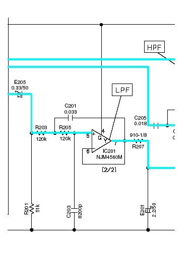

Hi Y'all,can I ask another?I have a car amp and I need to modify its 18db crossover from 80 hz to 40 hz,the cap is 0.0333 in value and is a surface mount type.Can I replace it with a non surface device? And will multiplying the value by 4 = 1.4uf set the frequency to 40hz?

I would expect an 18dB/octave crossover to have more than one capacitor?, a 12dB/octave one uses two capacitors, an 18dB/octave is likely to use three.
Your maths also seems wildly inaccurate?, how does 4 x 0.0333 = 1.4?.
This is assuming you're right in multipling by four to half the frequency?.
However, there's no problem replacing a SM component with a conventional one - it's only the shape and size that's different.
What are you actually trying to do?, presumably this is for a sub-woofer?.

It is a Sallen and Key 12db/octave lowpass filter with its two capacitors fairly far off the required 2:1 values. If you make only the 0.033uF capacitor way too big then I think it would almost oscillate and have a big peak at only a single frequency, like a bongo drum.
Don't listen to the descriptions of frequencies of only guitars and other stringed instruments. Modern synth'd music goes down to very low frequencies.
Lookup Sallen and Key Lowpass Filters in Google, modify the values of both capacitors using a proper 2:1 ratio, use a good sub-woofer, play hiphop music and lose your bet. :lol:
12dB/octave isn't very steep, the filter will still pass higher frequencies.
PS. If you want to win, use two subwoofers connected out-of-phase. Your friend won't hear any bass.
With a second look at the 4:1 ratio of the capacitors, it might be an 18dB/octave lowpass filter with its 3rd RC network elsewhere. All 3 capacitors will need to have their values doubled.

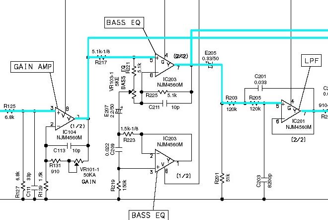

I'm sending more image
Here's more image. Cheers, Y'all!

I don't see the 3rd stage of an 18dB/octave Butterworth lowpass filter there. Maybe C201 and C203 don't have the proper ratio of 2:1 for a 12dB/octave Butterworth lowpass filter because they want it to provide a little boost just above its 80Hz cutoff frequency.
If you reduce the cutoff frequency of its lowpass filter then the Bass EQ circuit will still be set to boost and cut at the original higher frequency.
To cut its lowpass filter's cutoff frequency in half to 40Hz, double the values of C200 and C201. You won't find 0.066uF but you can use 0.068uF for C201, and you won't find 0.0164uF but you can use 0.018uF for C203 which is close enough.
A 12dB/octave Butterwoth lowpass filter will cut 40Hz to 1/2 power, 80 Hz to 1/4 power and 160Hz to 1/16 power. You will lose your bet because voices and ordinary bass frequencies will still be heard. :wink:

So I guess I loose the bet,thanks for your help.Should I lower the bass boost,seeing as its set at 50hz?Thanks everyone
Mikee55 :D
Re: Okay
50Hz is pretty low, and the Bass EQ circuit will also boost from 25Hz to 100Hz anyway so leave it like it is made.
