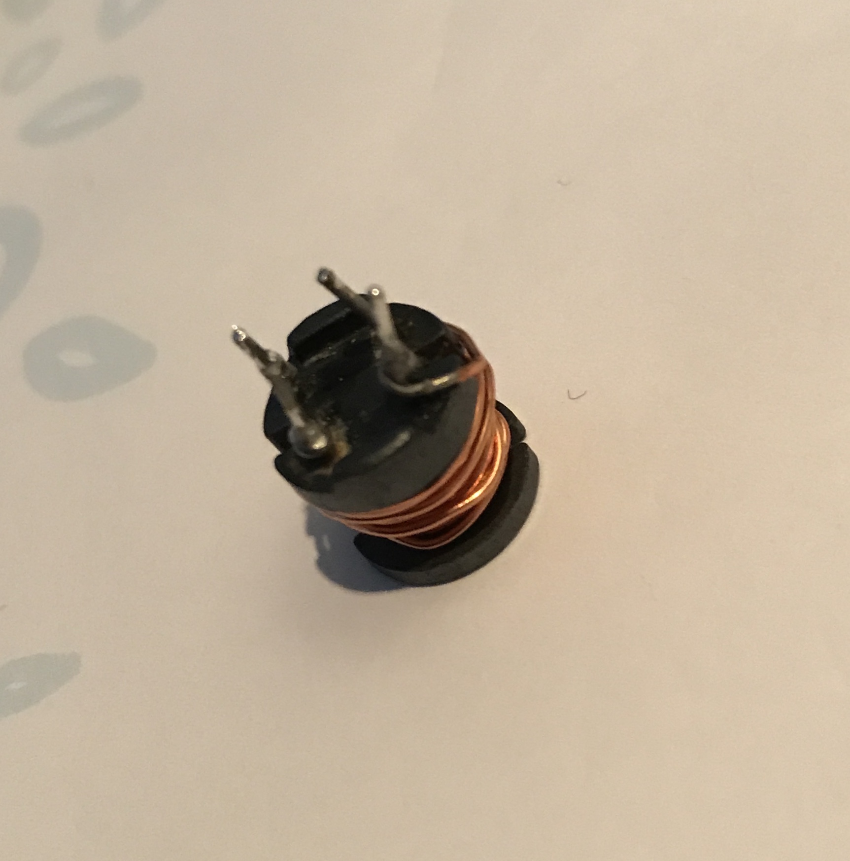

I am struggling to find a 4 pin replacement for my 560k H18 inductor.
I suspect any 2 leaded 58uH coil will do as the extra 2 pins are not doing much extra. But I could be badly wrong. Could anyone confirm before I do something bad?
What I got available here in Nz is a ELC09D560F - Panasonic 56 μH ±10% Ferrite Leaded Inductor, 1.1A Idc, 130mΩ Rdc ELC09D
I also have a complementary question. This inductor was making a very loud whine (pin points each component with a soundscope and it was screaming. What would usually make an inductor whine too loud? Inductor failure (how if it just a wire)? Surrounding components failing, capacitors, traces...? Power source issues?
Any help I appreciate.

The only 'fault' that could cause the inductor to whistle is loose windings, and that doesn't appear to have the windings fixed in any way - and it wouldn't affect operation.
I've repaired huge numbers of SMPSU's (thousands of them over a long period), and have never had such an inductor fail - there's not really anything to go wrong with them, and as it's a thick piece of wire it's unlikely to break.

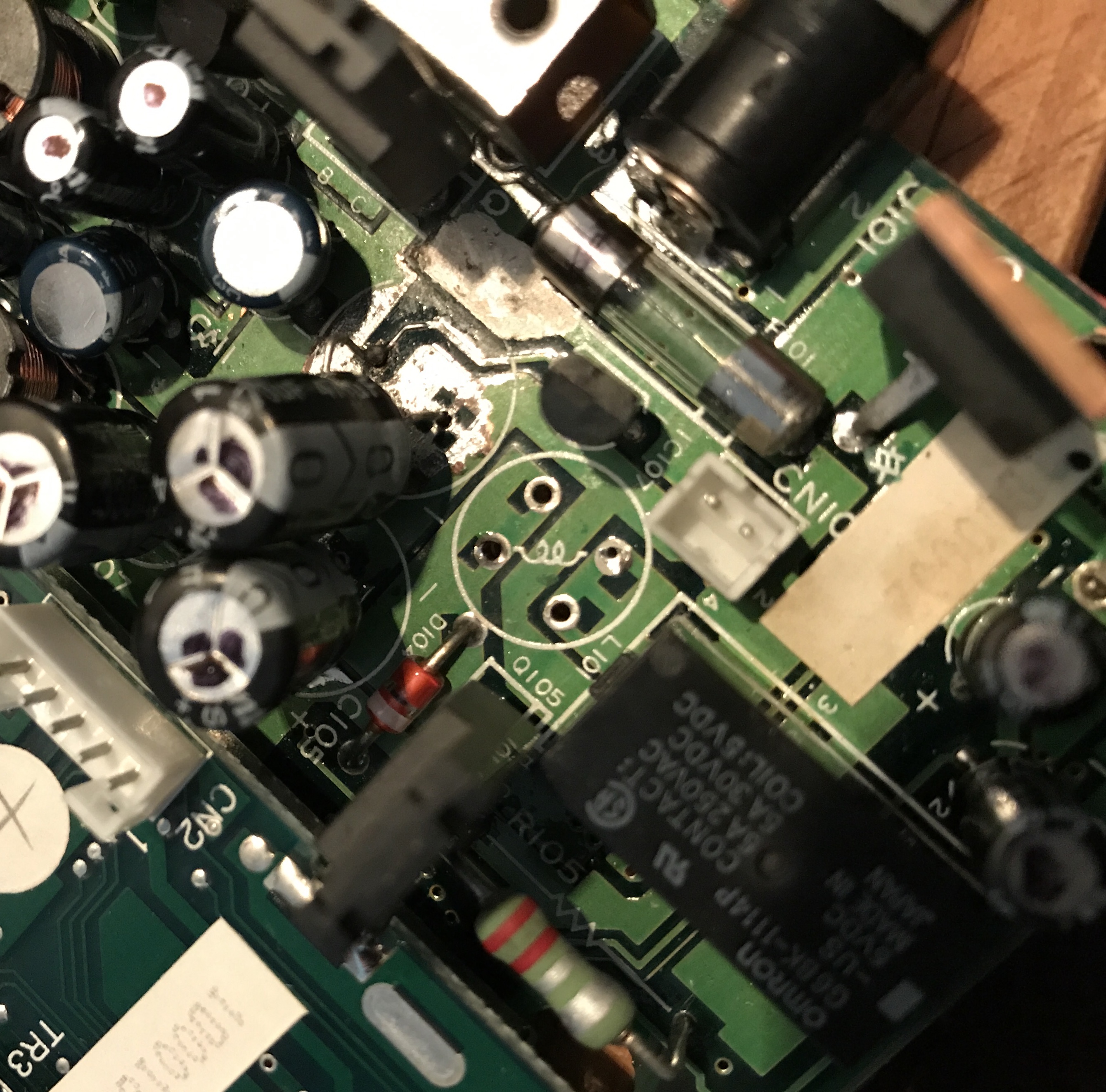

As you can clearly see from the PCB picture, it's simply a two wire inductor, the extra pins are for mechanical stability.

Four-leaded inductors are usually deployed as a common-mode choke in a differential pair of wires, like the power cord on a power supply... Trace out the circuit to see if this is the case. If yes, then a two-leaded inductor will not do.

What's with the capacitor just to the left of the inductor on the board?, it appears to be partially removed.
The capacitor was raised so I could have access to the traces underneath it. The previous capacitor leaked and damaged the traces.
As a feedback for the whine. I unwired the coil. Rewired it with a good coat of varnish and put it back. It is 90% quieter now.
