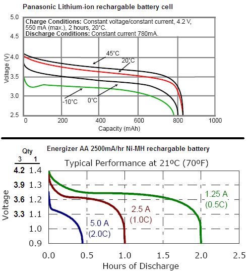

Hi Mark,
Three AA rechargable Ni-MH cells are a good match to a single Lithium-ion cell:
