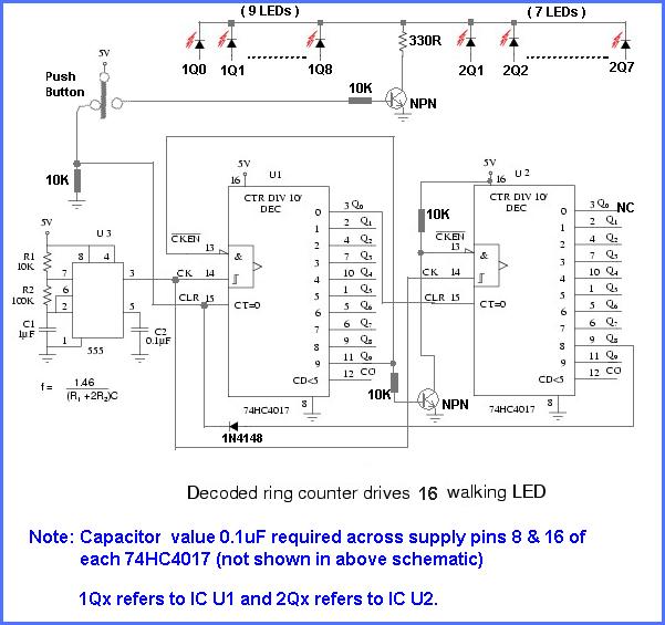

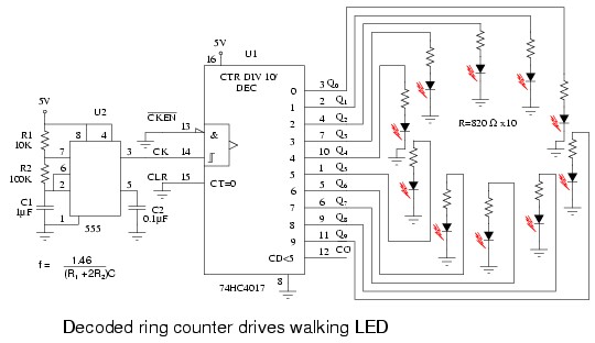

I found the following schematic that does exactly what I want to do but with 10 LED's and using one CD4017 and one 555 timer as suggested by eblc1388.
How can I change this design to get the 16 LED's loop sequence? How can I implement the IC's jbeng suggested?
U1 and U2 are held in reset state so both U1 & U2 Q0 go HIGH. However, no led is lit because the top NPN transistor is OFF. Clocking from 555 has no effect on these two counters.
When user pushes the button, the reset signal on U1 is removed and the top NPN is biased to conduct and the first LED lights up. 555 timer pulses would then advances the counts to 4017 and the corresponding output LEDs.
The trick here is to prevent the second 4017 from counting but enable it after the first 4017 reaches the Q9 state. As the clock is provided to both 4017s, the next 4017 would then count up. When it reaches Q8 state, Q8 output goes high and sends a reset to the first 4017 and the cycle begins again if the Push button is still pressed.
If user releases push button at any time, both U1 and U2 are then reset waiting for next operating.

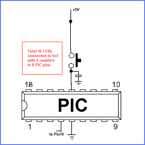

There is another option for you to consider. The circuit that uses a PIC is so much simpler and in many case cheaper than buying all the IC and transistors.
As Nigel has commented, people have to order parts anyway so they might as well get the PIC or a complete kit from you. I reckon a suitable PIC would cost no more than US$2 for this project.

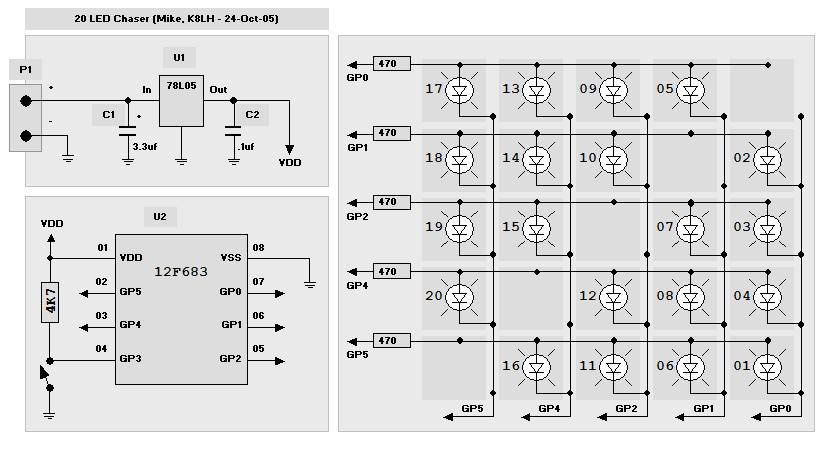

This really would be a 'cute' project for a little 8-pin PIC ($1.60 USD)... The LEDs are multiplexed using the N(N-1) scheme and could be scanned one column at a time (from schematic point of view) for decent brightness at a 20% duty cycle and a >100-Hz refresh rate using a Timer 2 interrupt routine... Use high efficiency low current LEDs (5-ma) and you could probably run the thing off a couple AA batteries for a good length of time and the hardware couldn't get much simpler; an 8-pin PIC, 6 resistors, a 0.1-uf bypass cap', and up to 20 low current LEDs... Pretty cool -- yes, no, huh?
Regards, Mike
