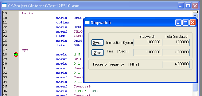

P Pommie Well-Known Member Most Helpful Member Jan 19, 2009 #21 Yup, definitely 80 cycles too long. Mike. Attachments Cycles.png 23.8 KB · Views: 153
mvs sarma Well-Known Member Jan 19, 2009 #22 Pommie said: Yup, definitely 80 cycles too long. Mike. Click to expand... Do you mean 80 instructions cycles longer?
mvs sarma Well-Known Member Jan 19, 2009 #23 Pommie said: Yup, definitely 80 cycles too long. Mike. Click to expand... I didn't know how to set up this in MPLAB, Pommie. Try to guide me.
