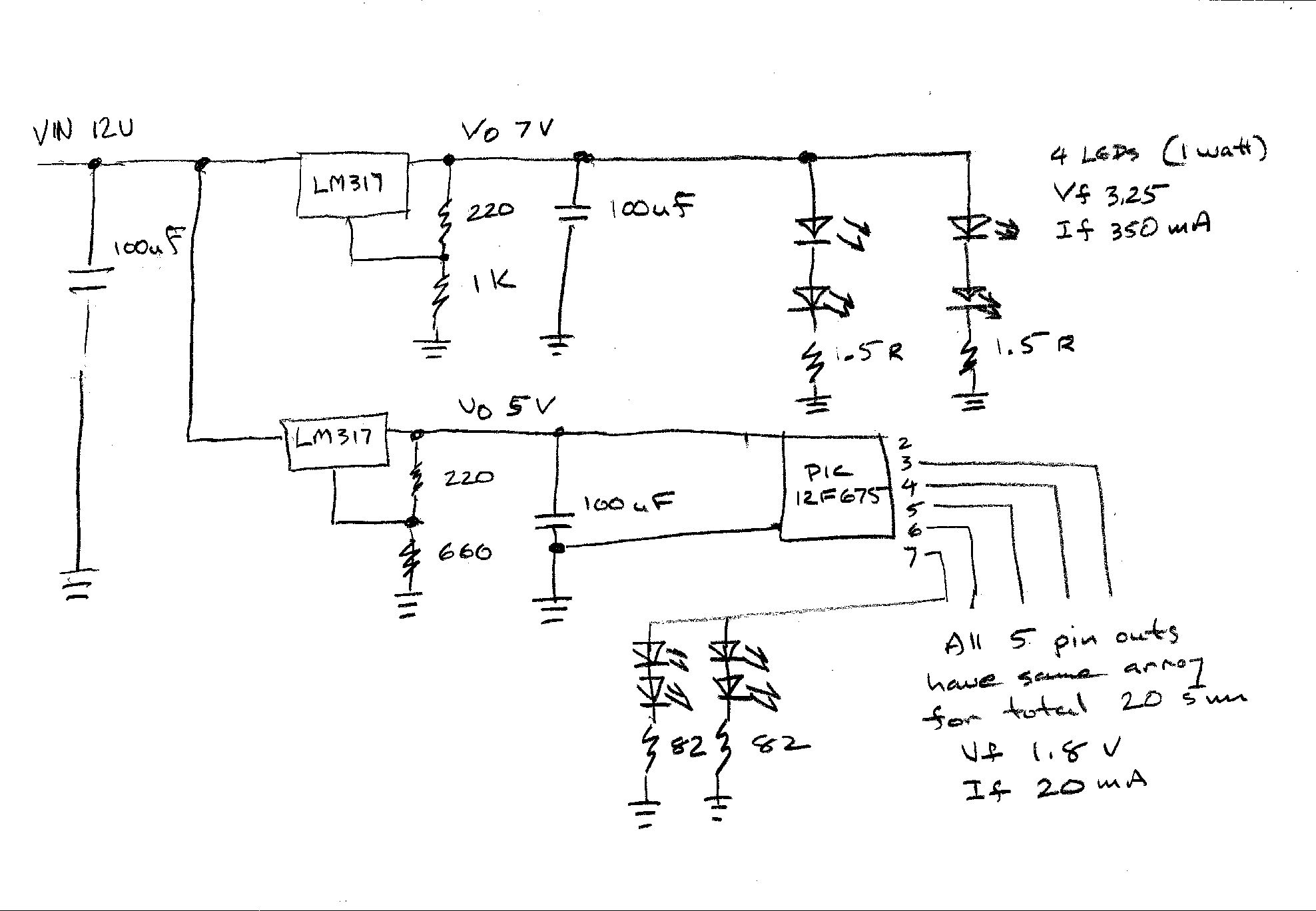

require advice for hot lm317
justwantin
I'm looking for some advice if possible

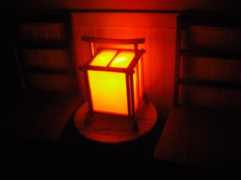

I have been working on the attached circuit for use in decorative lanterns. The 1 watt LED's provide white light while a cluster of 5mm yellow LED's in the middle simulate the flickering of an oil lamp. I thought my circuit was OK and have been trying out various LED configurations using a benchtop PS for a week or so. I now have my LED configuration looking good through the ricepaper and thought before I solder it all up on a PCB I'd try it out using a 12V 1A power plug. The online LED wizards I used to work out my arrays figured I'd be drawing 700mA for the one watt LEDs and 200mA for the 5mm LEDs but actually I measured 350-60 mA and 2-5 mA respectively> I did not expect the 5mm's to draw so little flickering randomly
The short of it is that while I had no heat problems on either LM317 working off the bench top PS at 12.5V I have a serious heat problem on the top LM317 ( 7V ) when hooked up to the 12V, 1A power plug. I did not push it too far after 80C but changed to a larger heatsink for no joy.
When I hooked up my multimeter in line between the power plug and the circuit my overheating problem went away. This leads me to believe my problem is solvable without using an excessivly large heatsink but it's beyond my level of knowledge at present.
I hope my hasty schematic is clear enough, I'm fairly new to all of this.

try putting .1uf, or some small cap values on the inputs and outputs of your lm317 parts.
I have one between the power plug and the 2 lm317s and one each on the output. .1uf or 100?. I'm using the small ceramic marked 101.
use one for each lm317 near its input and output. I mean near, distance does matter.

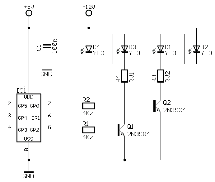

first off why would you want to waste an adjustable voltage regulator supplying the MCU? For the top part use a 100nF cap at the input pin of the LM317. The regulator probably produces excessive heat due to oscillations.
Also you will fry the MCU connecting relatively high load directly to the port pins. The LEDs won't get their nominal current because the chip can't source the required current. Use NPN-driver transistors instead and connect the LEDs to them using the output of the LM317 for LED supply to avoid power fluctuations for the MCU supply.
See attachment

Mikebits, I have one cap infront of the two lm317's, I'll change that tomorrow and see how that goes. and I'll back the ones on the output side closer to the lm317s. Can you have too many capacitors? it is my understanding that one should be just before the PIC.
Boncuk, I didn't realise I was wasting regulators, It was the only way I could figure out getting both 7V and 5V out of a single 12V supply. I am doing something similar with an lm317/6V supply to 4.5V to switch 15 LEDs with a microchip in another lantern we use in or home for a nightlight. This circuit has run every night for 3 months without frying anything (see attached). Thanks for the schematic I'll study it as I hope to learn a bit about NPN transistors in my next project. Note, however that I am switching 4 LEDs per pin for a total of 20 LEDs, I'm not too sure I'd get there with your approach.

With 12v on input and 7v on output of LM317 at current draw of 700 mA you have 3.5 watts of heat dissipation on LM317. That requires a pretty good sized heat sink. When you say it does not get hot when DVM is in series is just means the resistance of the your DVM is dropping the voltage and part of the heat dissipation is in the DVM.
A 0.5 volt drop across ballast resistor is not much margin for variation in LED's as they get warm. There will be variation in the LED current that may destroy them.

101 is only 100pF; the minimum capacitors around a 317 should be 0.1uF, which would be 104
You say you used a 12V 1A power plug. Is this an unregulated wall-type plug? The voltage could be higher than 12V.
