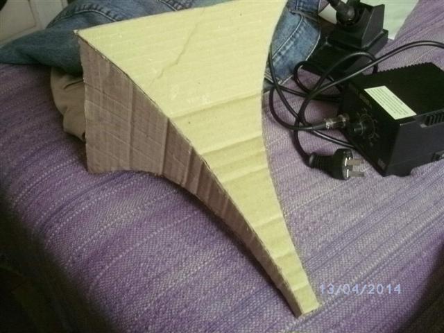

To test a cardboard made directional microphone I will use a universal tripod for cameras.
What fitting should I ask for, fitted to the horn for mounting it on the tripod? Honestly I have no idea where to look for.
For the moment I found just a nut with the right thread.
I THINK I know what your looking for: https://www.amazon.com/
Look for "tripod gimbal mount"
Pretty sure the camera screws are 1/4-20. Also look for camera or tripod screws.
Another possibility is to make what you need. To make it out of wood, you could use a 1/4-20 T-nut.
You could use a self-clinching nut if the material is sheet metal: **broken link removed**
or you can tap a 1/4-20 hole into an aluminum plate and fasten as you see fit. Easy enough to do.

No. No mock-ups. Just the horn in the picture.
I need to keep it stable on the bench properly aimed to a sound source (in a fixed direction and elevation). Nothing fancy.

I have a number of cheap tripods and they all use 1/4 20 thread and all have the gimbals. You need to identify the thread on your tripod stud. If nothing else take it to a hardware store and try a few nuts on it. Epoxy a normal or long nut to your horn. I would cut a wood block to fit the horn. Then I would drill a hole for the nut and epoxy it in.
I forget the correct name for the long nuts. Might be coupler nuts.
Now some tripods have shoes. You can make a block of wood with a shoe bottom and attach it to the horn. I made this DIY adapter to hold my Ipod Touch.
