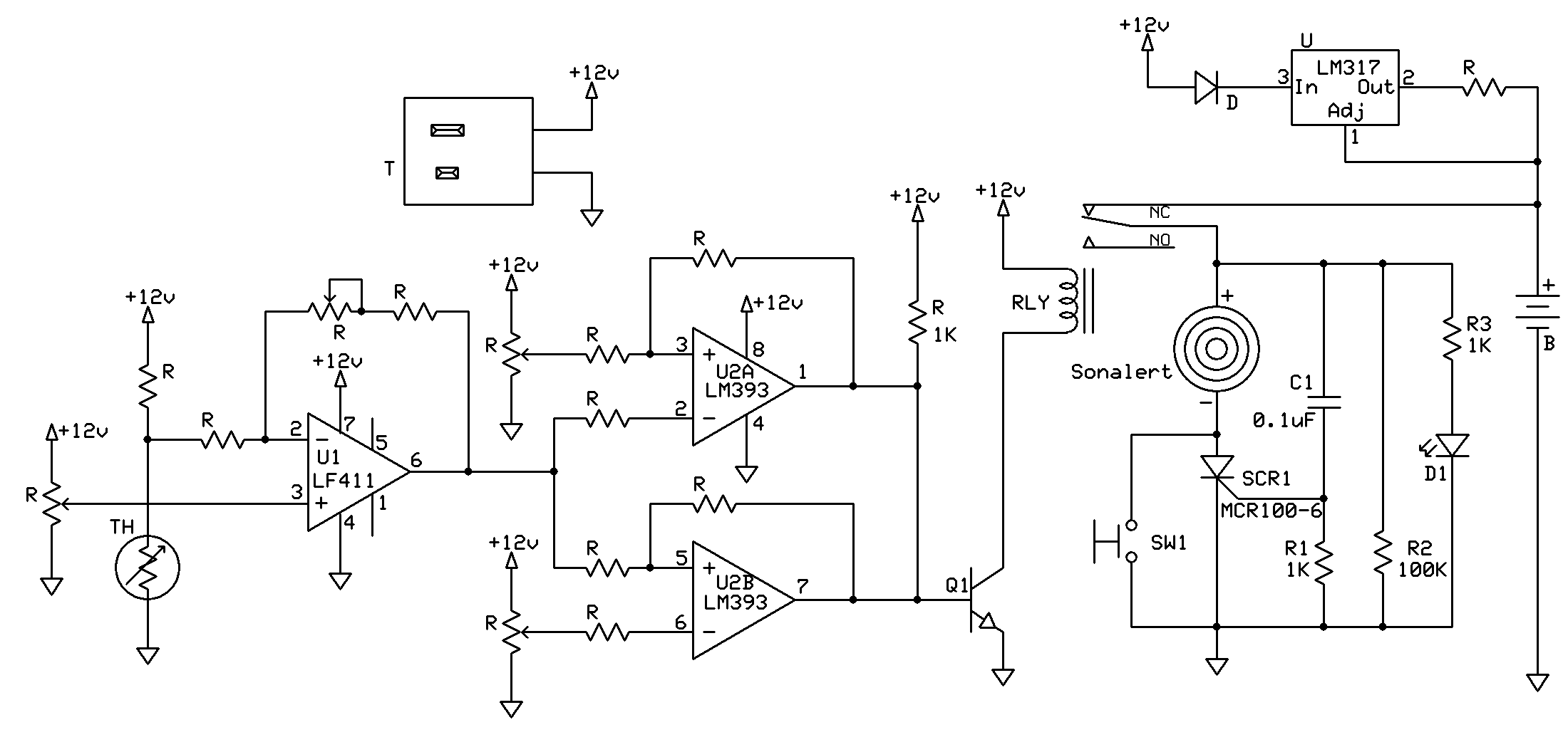

OK, I'm going to give this a shot. Probably should have just done a block diagram...but go ahead and tear it apart.
I couldn't find a circuit for a window comparator with hysteresis on both levels. No Values on most things because I don't know.
U1 sets an offset and gain to get a good output from the thermistor half bridge. U2 forms a comparator with hysteresis, so Q1 is turned on and holds the relay on as long temp is within range. The alarm/silence circuit (thanks mvs sarma), is switched by the relay and powered by a Ni-cad battery that is charged by the constant current LM317. SW1 silences the alarm, but the LED D1 stays on to indicate that the system is still in alarm. Everything is powered by a wall wart. If power is lost the relay drops out and triggers the alarm.

Just a few comments:
I'd probably go with a voltage comparator instead of a relay.
There shouldn't be any need for hysteresis, if it triggers an SCR or a flip-flop.
I'd probably include a bypass resistor across the buzzer in case the current through it drops below the SCR's holding current as it oscillates.
We haven't been given enough information anyway, like at what voltage should the alarm sound at?
Is it operating off the mains or a battery?
I'll have a go anyway, just because I've never done this before.

Hero,
I think kwame wants the alarm to sound when he looses "mains" power, not battery power....or when the temperature exceeds the high and low limits of 36C or 39C. My guess is that the loss of mains power is all or nothing.
