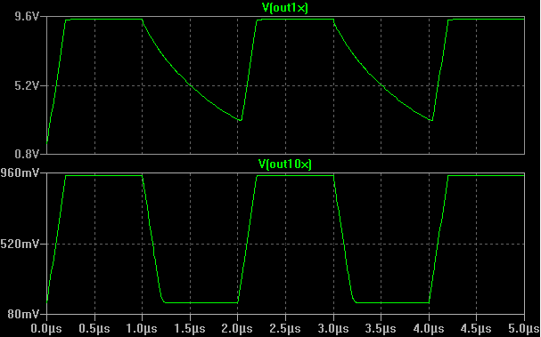

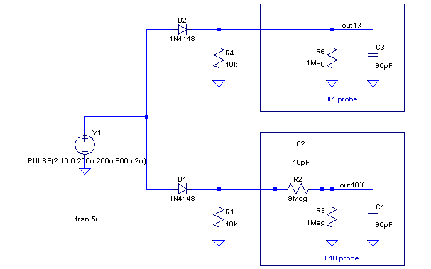

The rising edge looks the same in both circuits because the capacitor charges (rising edge) through the diode, which is a low impedance in the forward direction. When the input falls, the 90pF capacitor has to discharge through the 10k resistor. This discharge time is slower than the fall time of the input, so the diode cuts off (does not conduct).Thank you for this.
Could you explain these two waveforms?
I dont understand why in the 1x waveform, the rise time stays the same, but the fall time gets longer, why is that?
