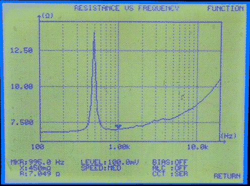

It has a lot to do with impedance. Impedance varies with frequency because the components of impedance, resistance and reactance, vary with frequency. The AC resistance of the voice coil is composed of the DC resistance plus a component that increases with frequency. If you were to remove the DC resistance of the voice coil, the AC resistance would change a lot, because the DC resistance is a substantial part of the AC resistance.

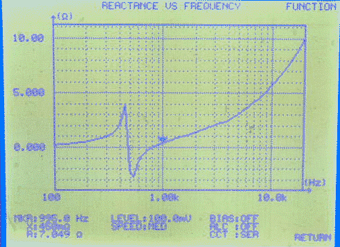

I've attached 3 images showing the AC resistance, reactance and impedance of a raw driver, with a nominal impedance of 8Ω, as the frequency varies from 100 Hz to 20 kHz.
As you can see, at low frequencies the AC resistance is essentially the same as the DC resistance (which measures 6.8Ω with my Fluke meter).
The impedance of the driver reaches 8Ω somewhere between 3 and 4kHz. This behavior is typical of all drivers; the DC resistance is just a little less than the nominal impedance rating.

You cannot measure the impedance by itself. It is in series with the DC resistance of the voice coil.
This seems a little confused.
The DC resistance of the voice coil is a part of the impedance.
Measuring the impedance by itself is quite possible; you just use an LCR meter. See my other post for the measurement.
Did you mean to say that you can't measure the reactance? Or, perhaps you meant that you can't measure the part of the impedance which is exclusive of the DC resistance. But, of course, you can simply measure the AC resistance and then subtract the DC resistance if you want to know the part of the resistance which is due to the fact that the measurement is at a frequency above DC.
