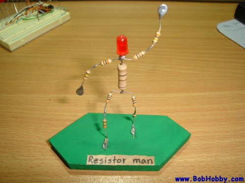

Today while searching through google I came across this funny stuff.:D

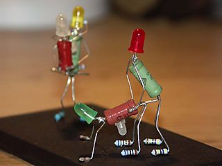

Somehow I managed to make one looking like the first picture. My doubt is whether in the second picture, the body part uses resistor or a cap :)
How can I blink the LED's by adding just a single transistor, and where should I place it without affecting the appearance:eek:
Nice thing to try as a gift to somebody:p

Build the driver circuits into the base so they're hidden. Make the base thicker to fit the circuit, batteries and a switch.
I think the 2nd pic is all resistors, no caps. They might be wirewound resistors.
I don't know if you're trying to make the 1st pic or the 2nd. If you're doing the 1st, wire it up so one leg is the + and the other leg is the -. If you're doing the 2nd, have the man be one half of the circuit and the woman the other half. That will minimize any extra wires you need to run into the base. Then, make the resistors the right values so they act as the current limiting resistors for the LEDs. ;)
If you inverse parallel the LEDs you can flash them independently or alternately without extra wires.

By the way, the components used for body parts in the second picture are definitely resistors; probably 3W resistors given their size.
I made my own version of the first picture, but I used a 555 circuit to make my resistor man's head blink at ~3Hz and made a couple of other slight modifications. My niece and nephew love it :D
