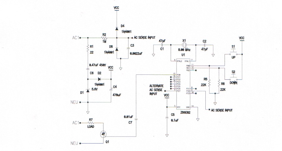

thanks for the replies. i raised up this issue because some of the schematic doesn't state the power value of the resistor.

thanks for the tip panic mode. i really appreciate it. but i want to make sure that it is really safe using 1/4 W resisitor according to the attached schematic. i got the schematic from zilog website on power phase control using Z8 Encore microcontroller.

If the resister value is 1k or over you are safe to use low wattage, a 1/8 W will be happy to sit all day shorting out 240V mains voltage.
It's not quite so. Power disipation is calculated by
P=U*U/R
So if you use 220V and 1kOhm (1000 Ohm) heat disipation is
P=220*220/1000=48.4Watt.
1/8Watt (or 0.125Watt) is much less than that.
kekek, you can go ahead and use 1/4Watt or even 1/8Watt
for all resistors in your circuit - except R7 which is actually
AC load you are controlling.
thanks a lot guys... i was thinking of using power disipation equation before, but i'm not so sure if i am on the right track... anyway, thanks a lot.
